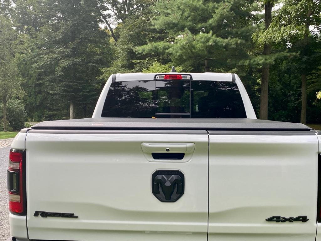

Anyone that has replaced the factory brackets seeing any adverse effects with tailgate alignment, etc.? I have a Lomax cover I want to reuse - looks like the design/install is exactly the same as the Waethertech and I'm thrilled to hear there might be a solution for the MFT.
Everyone I am aware who have installed Right On Brackets have had no issues with bed alignment. The Right On Brackets are stronger than OEM if you remove the cross-member on the OEM. Plus, the guys at Right On Brackets are very accessible, members in here, and answer questions pretty promptly on this forum. If you call them or email them, they are immediately responsive. If you run across any issues with their brackets and your tonneau, I am positive they will work with you to figure it out.
No, I am not a paid spokesman for Right On Bracket, nor do I get any benefit from promoting their product. Their product was the solution to my problem, that problem being the same problem you are experiencing now with your MFT and chosen tonneau.
Seriously, if you have questions... PM RightOnBracket in here. He will answer your question.

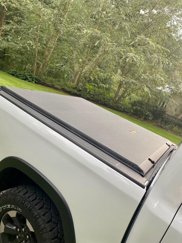

RIGHT ON! ... RIghtOnBracket! It worked. Your brackets were the solution to fitting the WeatherTech Alloy Tri-Fold Tonneau on my Limited. I installed the WeatherTech rails under your brackets and it looks great. Sorry for scratching your fine craftsmanship with my wrench, but the fit was wonderful and the screw holes aligned perfectly. Placing the bracket on top of the rails caused me to have to work the bracket a little to get the holes to line up; nevertheless . . . Thank you. (y)(y)
The only issue is that I have to put a little more weatherstripping under the front of the tonneau on top of the bulkhead because the brackets cause the tonneau to sit about 1/8 of an inch further back from the bulkhead than if no brackets were present. That is a small inconvenience for a wonderful looking tonneau that I could not have installed without your ingenuity and efforts.
