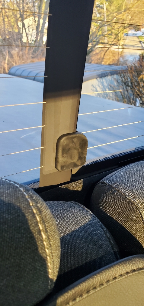

Just picked my truck up after having the rear glass & frame replaced. I've had the truck for 2.5 years and have 32,500 miles so everything was covered under warranty. Cost being billed to Ram was $895. Dropped my truck off last night (so it could warm in their garage overnight) then I picked it up end of day today. Very pleased. I noticed on the new glass what looks.like a rubber bumper of some sort at the bottom back of the sliding piece. Does this stay on the window? Also I didn't see a part number listed on the invoice but I'm assuming it's the most recent version of the back glass that has the corrected parts.

Thanks for posting that. I'm pretty sure the rubber piece is a stop, and you should leave it there. I think my 2021 has that rubber piece, but I don't remember off the top of my head. I can look when I get home from work if I remember.

Edit: I just checked my Limited, and it has the same rubber piece that your picture shows. It's supposed to be there.

That is part of your rear window defroster circuit for the slider, leave it alone!
