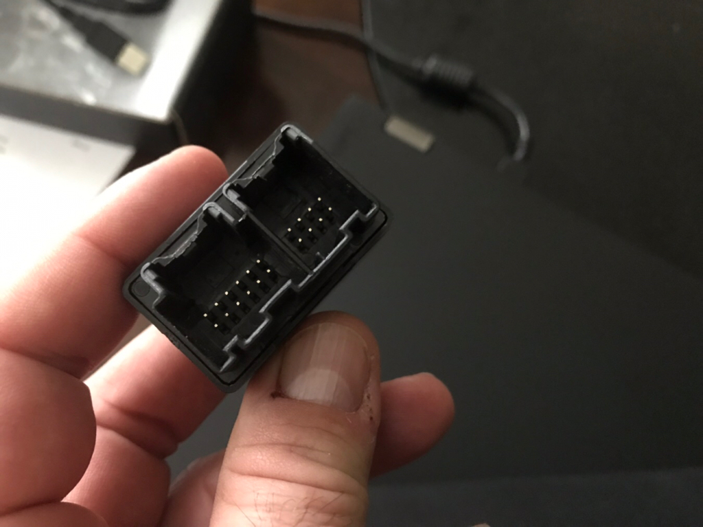

I’m slow I guess. I read the manual and looked at the picture. I don’t see where to plug this in. Can anyone post a few pictures or a video that slowly shows where this plugs in? Truck is the 2019 ram 1500 new body Style. Here is a picture of what was sent to me.

There is a module under the steering wheel and to the left of the brake pedal (away from the gas pedal) you have to unplug the wires from that module and then plug those wires into the tazer module. I didn't remove the factory one and i zip tied the new module to a wiring harness. Hope this helps

It's deceiving, it's just above the weight on the emergency brake release cable. It's directly below your lights and adjustable peddle switches.

Look at the photo on the install page. Clear as day. Looks like 2 ethernet cables

You are looking for 2 sets of plugs and wires that are 1 on top of the other that are plugged into a board with other circuits. From the fuse box under the dash look LEFT about 6 inches. You have to look at an angle so you can see behind the light switch near the firewall. You will see a shiny dash support bracket. The plugs are to the LEFT of this bracket. You are not looking for a module to unplug like you are holding, just a circuit board which wires plug into. You do not remove this board, just the 2 plugs and than plug them into the TAZER and the TAZER will just hang there and the circuit board plugs stay empty. Tuck the TAZER behind some wires so you can access it to program. Hope this helps. :)
