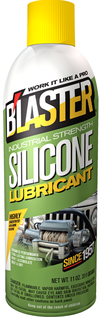

PB Blaster really isn't lubricant. It's a penetrating oil. It may actually loosen up debris and make it worse. I havent tried taking mine apart to see about lubrication. Mainly because it still operates fine.

I use this on tons of stuff, is that not PB Blaster?
I guess they have different new products under the general name. When most people say PB Blaster, they are talking about the original product which is a penetrating oil.
