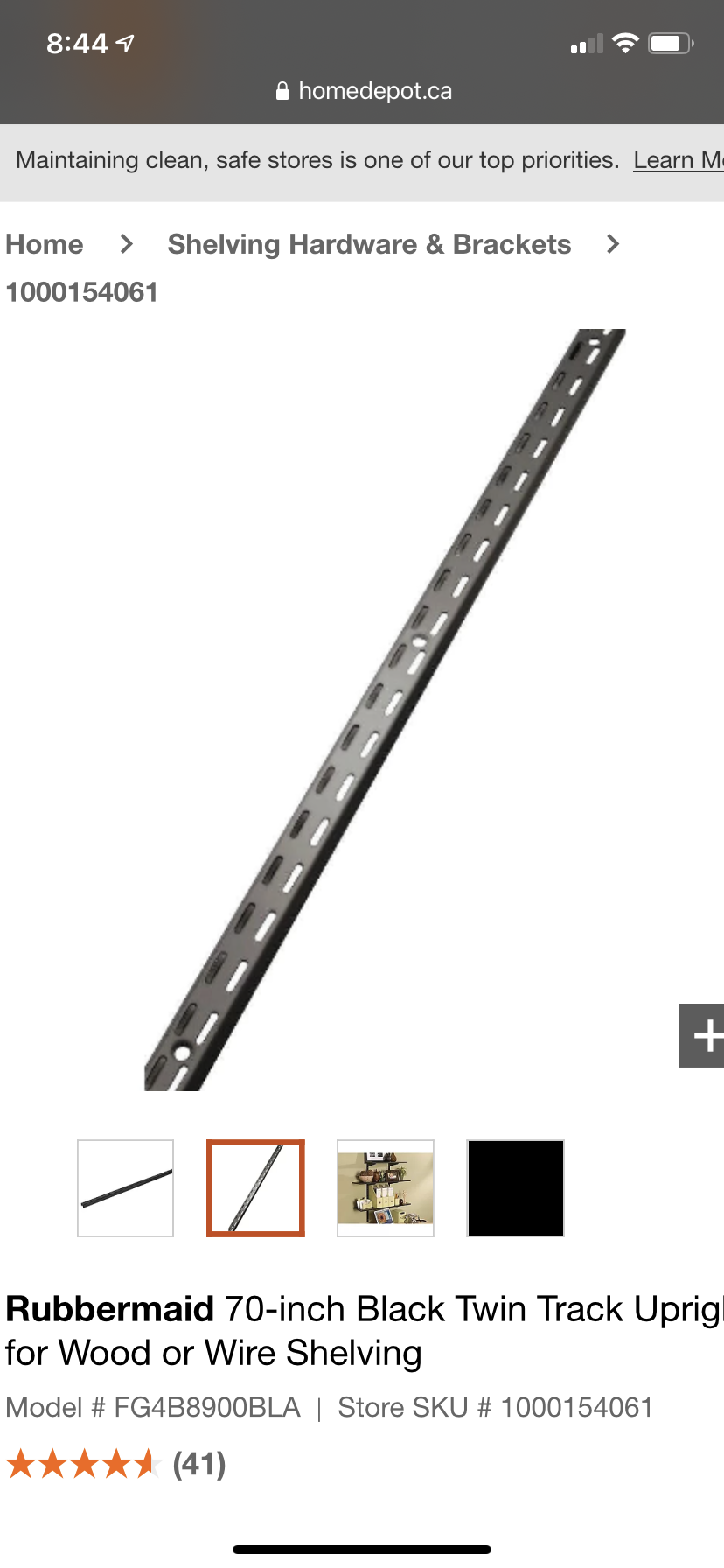

Got one of these from Home Depot. Cut to length, and notched in for the bumps and tailgate wiring. Drilled into the plastic, and nut+bolts in place
All wired into a curt harness
All easy to remove if need be.
