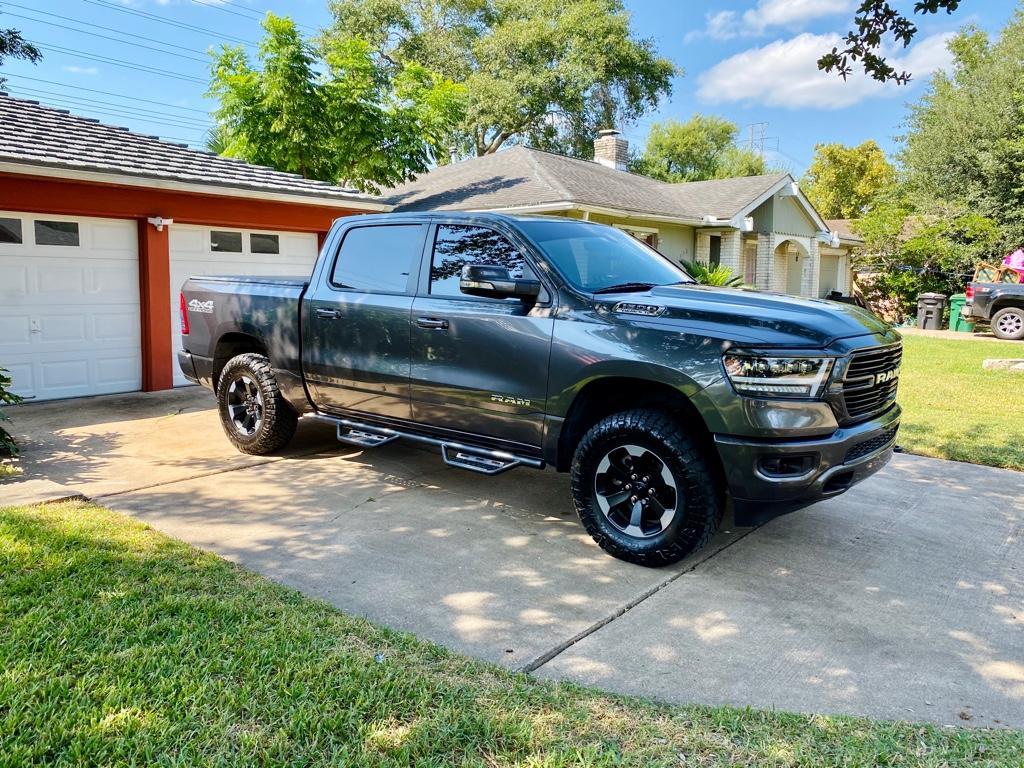

I went with rebel 18s and 285/70r18. But better ride. Also have a bilstien 5100 level which made it even better.

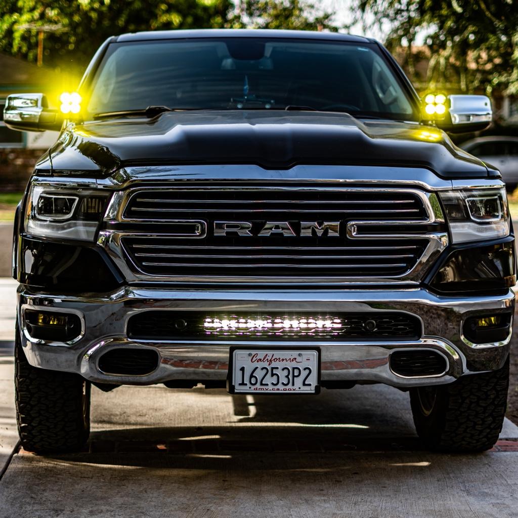

My current setup is 2019 1500 with 20’ and have 285/60R20 KO2s. I didn’t feel like trying to buy wheels yet so I’ve been happy with them. Smaller wheel size is usually better for more “meat” on the tire since you can air down more.
Can you tell me about your hood light set up?
I have baja design XL80 sports with zroadz roof mounting brackets.
