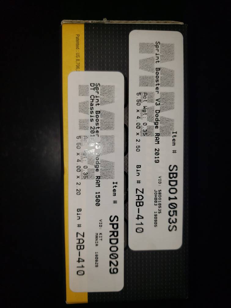

Im looking at getting one of these, but am finding conflicting model numbers for which one to get. Ive seen the SPRDO029 being used and the SBDO1053S is whats kinda listed for our trucks on the website ( all its listing for is the DT chassis )
So which one is actually the correct part number? I don't wanna throw the better part of $400 around on the incorrect part only to have to wait to get the correct one.
The SBDO1053S is what I needed for my 2019 Laramie.
I’m also using the SBDO1053S on my 2019 Limited with good success.
Looks like they may be renumbering.

just orderd a SB today, cant wait. Tried looking on Amazon with no luck for my 2019. Ended up ordering from SB themselves. wonder what product code i'll be getting.
need some help, just got my SB in and it does not appear like they sent me the right unit as the connectors are too small to fit onto my pedal connector. THe box designates the same ID as referenced above for my 2019 Ram 1500 but what they had sent appears to be a smaller sized dongle. I am wondering if I am trying to connect it to the proper location.
any help would be greatly appreciated.
My item # SBD01043S
SPRD0034
Your just trying to place it between the pedal and the cable to the pedal correct? It’s been awhile since I plugged mine in I remember it’s snug
You know what’s really sad is I double checked mine before placing the order. The invoice had a completely different number then what arrived. Fortunately for me the one I needed is the one that was sent. Not sure what’s going on with the swapping of part numbers.01031601-6B89-4280-A441-8D47168B8C16.jpeg
