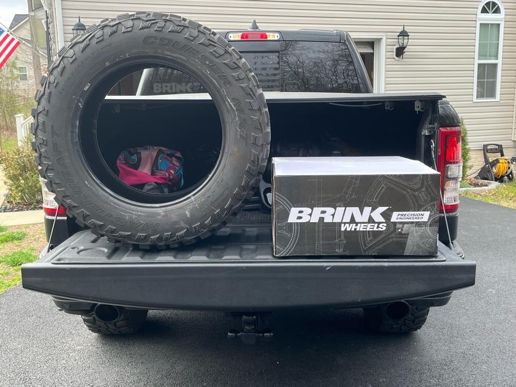

Welcome Nehal. Let us know it this works. I may get an OEM rim and keep it in the bed. I have a truck cap so there is room.
Sorry for the late response, I loose track of all the dif ram forums .lol...

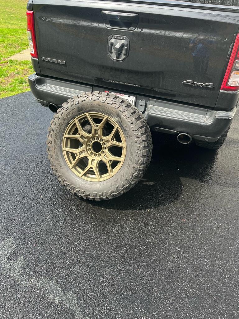

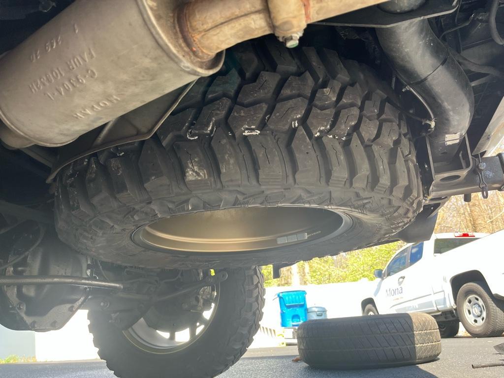

But yes I went ahead with this plan and it worked.
Obviously since this tire is wider than the original spare it sits a bit lower, but I wasnt too concerned, considering my lift. (Don't off road)
