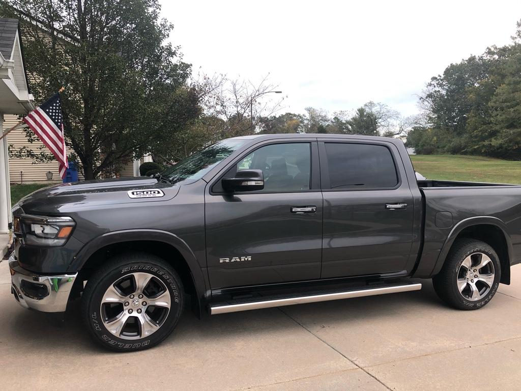

I did not get before pictures, but I snapped a quick shot this morning to show the mirror caps installed.
