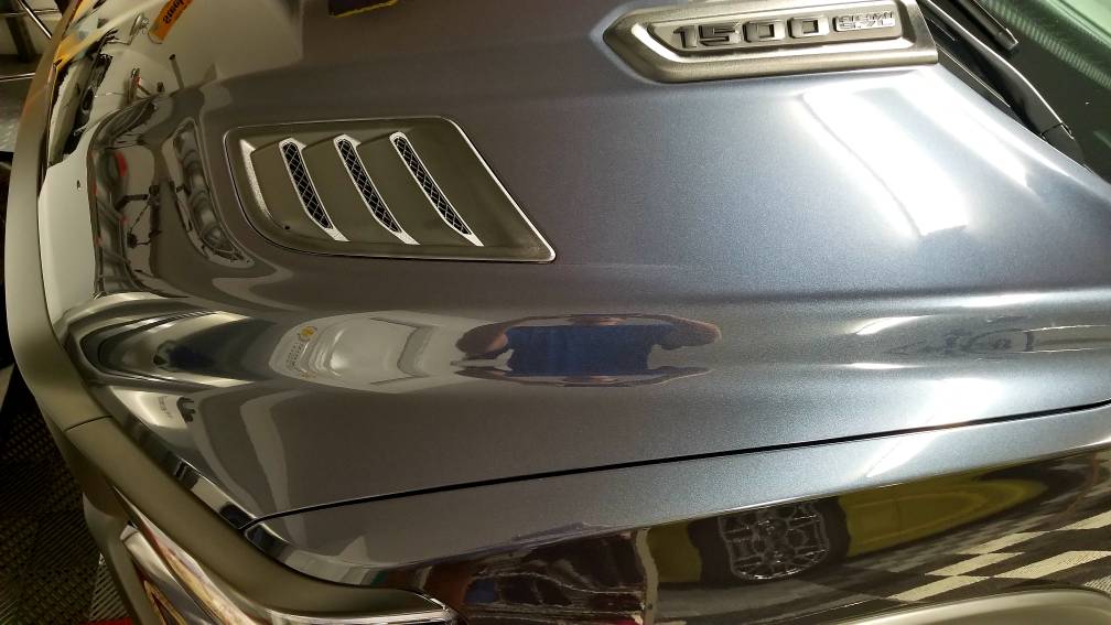

Teaser pic, started the Adams kit. I clayed and only had to do a very light pass with Adams correcting polish on their orange pad. I'm pretty impressed with the factory paint (Max Steel).
Liking the Adams kit so far however the Sonax is a little easier to work with being an aerosol and I like their little applicators. The Adams does seem to be giving a better finish. This is before curing or the boost.

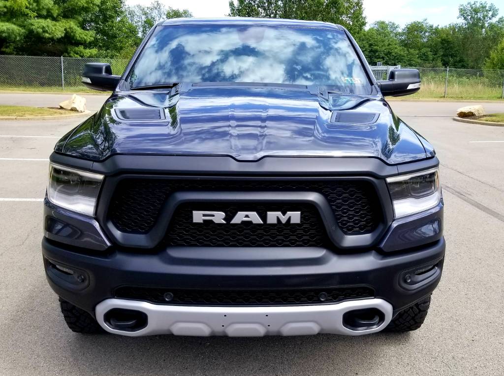

Truck looks really good already.

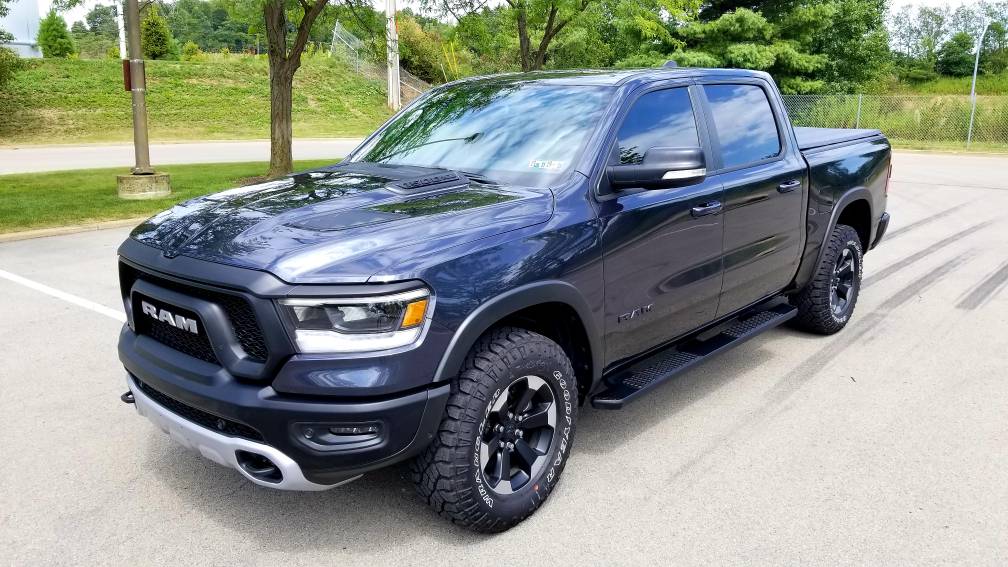

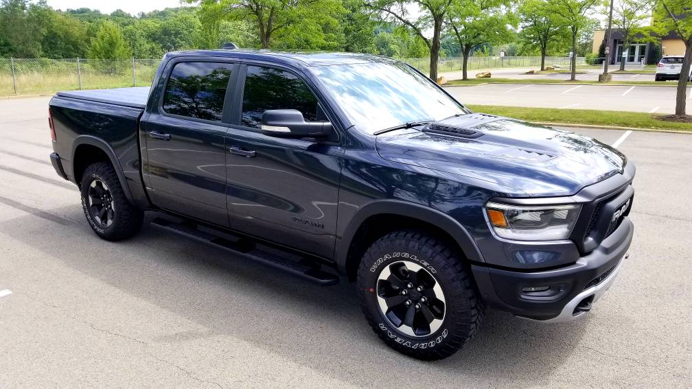

Final results. Couldn't find any sun to show off that metal flake.

I used Adams correcting polish on their orange pad. It's light and probably could have used a white pad as I didn't have any swirls or scratches.
