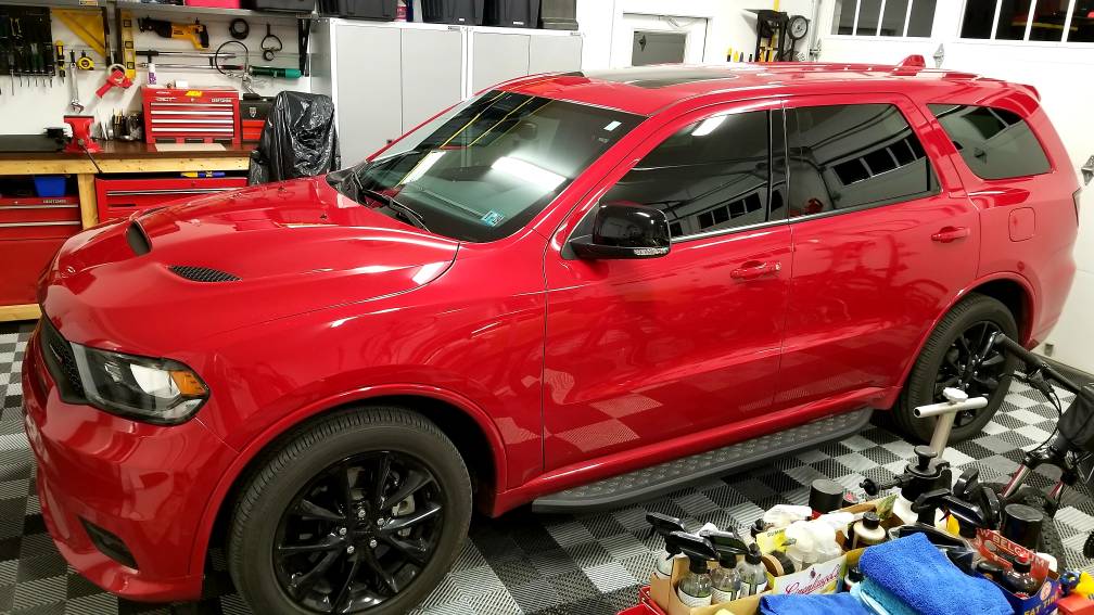

I have the Adams kit out in the garage waiting to get applied. I usually use Sonax CC36 which holds up about a year or so but have always liked Adams products so wanted to give it a try on the Rebel. Will use their light correcting polish on an orange pad with the DA first. I think they claim 18-24 month duration on this.
Here's my last Sonax job, probably 4 hours into it. Don't need it any shinier lol.
