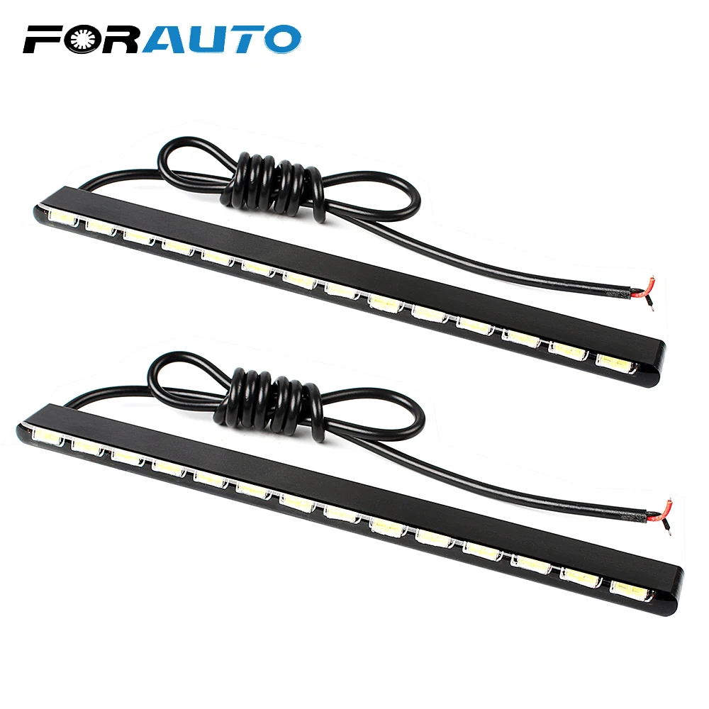

I had a proper look at my light bar under the tailgate and its only small but its bright, I've decided the angle of it is too vertical or its too much of a spotlight beam (will check again) hence the cast of it starts at the green backup lines. Can't alter the angle of it though or the tailgate will hit it when open, I might try having a look for a couple of wide beam really slimline LED strips for each side of the existing and mount it at an angle.
Thats indeed one of the options I ordered, and I think it has the best chance of success. Mounting them under an angle might be challenging, as they are fitted with adhesive strips.

Basically I have 2 types of LED's waiting to be tested now.
One consists of 2 strips of roughly 200mm long, very low profile, think around 6 or 7 mm high. They seem to be producing quite a bunch of light, nicely spread over a broad area.
The other is a single unit, more intended for off-road lights I guess. It seems to have a much stronger spot-pattern, and is much clunkier, but it has a bracket which allows for easy adjustment of the angle.
I was thinking of seeing if I could use a uPVC edge ramp usually used for transitions in flooring.
