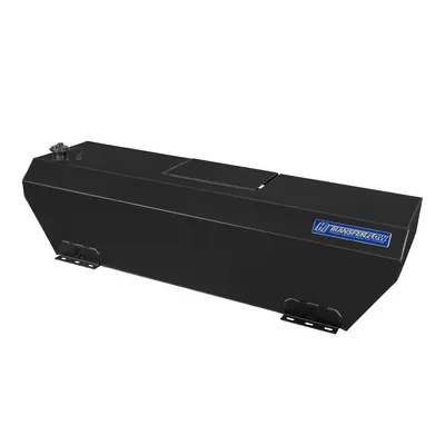

For those in need of serious fuel capacity, Transferflow makes in bed auxiliary tanks that transfers to the OEM tank automatically
Only problem I see is the closed system on the Ram, and some state and federal regulations concerning a transfer tank being connected directly to the vehicle fuel tank. Also, some state and federal parks will not allow you to park in any covered parking areas.
