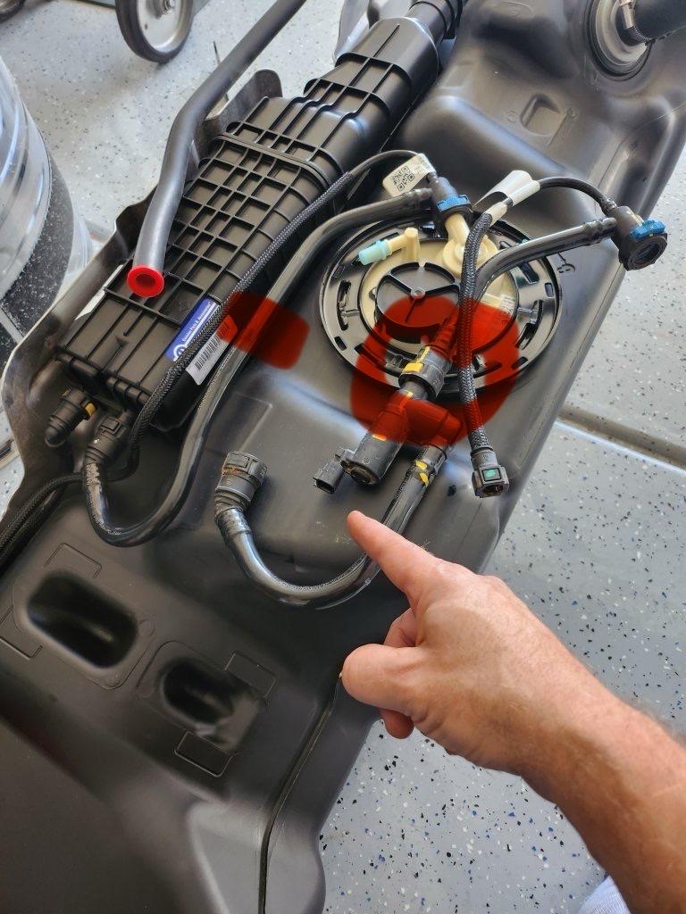

Can you not swap the old hose w/ the two extra connections onto the new pump and new canister?
What about the wiring that you unplugged from (those connection) from the original 23 gallon setup? Is that replaced with the swap or is that one of the wiring connect that still remain in the truck ? Hopefully this is understandable lol.
Nvm I see one of the new connections is longer. Yeah I would probably disconnect at the fitting (circled) then splice the old connection into the new. Not sure if the hose diameter is the same where you can just slide the cut hose over (where you disconnect from the fitting) then just use a hose clamp for added insurance.
I cut the new fuel bundle hose and used some parts off old tank ,a few clamps and this is what i came up with lol

Hey that should work. Of course check for leaks once everything’s back in and running.
Yeah i will check as soon as i get the right fuel line ,the one with the heat wrap on it going to the engine was wrong , it was to long , i thinknit was for a 19 and i have a 22 built 7/18/22
