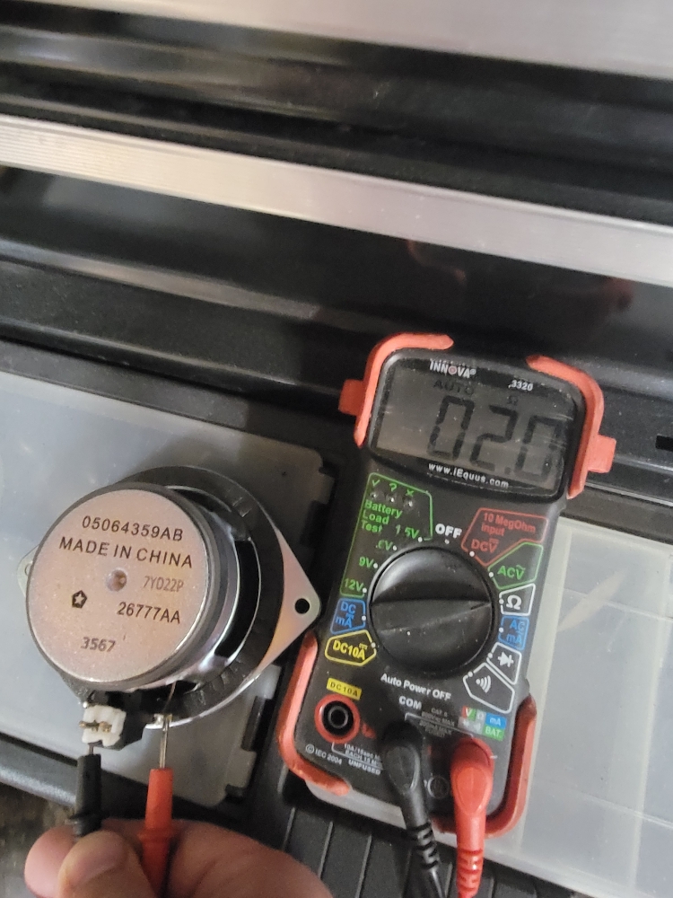

Replaced 3.5” Factory Dash Speakers
I don't know, I haven't removed them.
Sent from my SM-G981U using Tapatalk

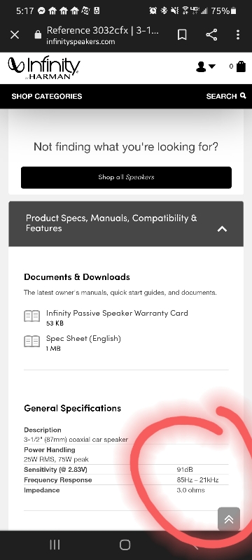

Infinity 3.0 Ohms, factory 3.0 Ohms
does anyone know what ohm the original speakers were and what ohm the new speakers are?
Dash speakers are 2 ohm, infinity are 3.0 ohm.
Door speakers are also 2 ohm, though I haven't removed them to check.
