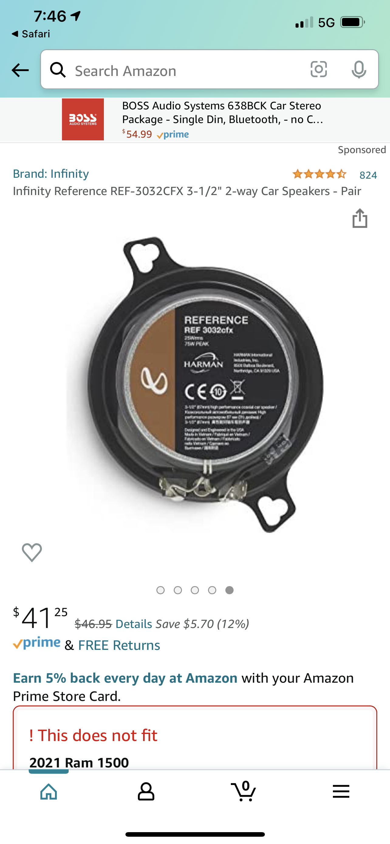

Can anyone tell me the following stuff is right to order? Might order a extra one to do the middle speaker as well I have the alpine system

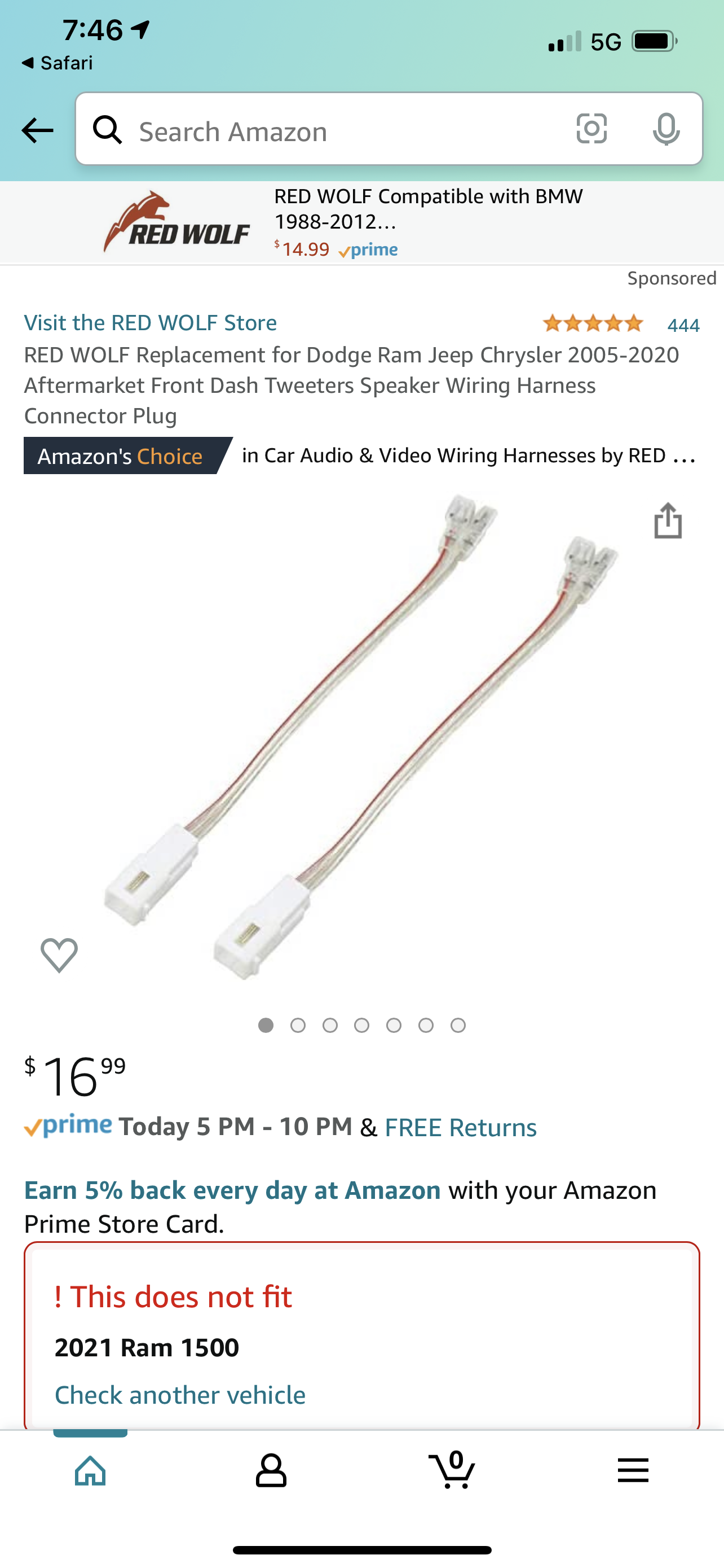

For the 3.5 dahs corners and center you need the right connector as the ones for the doors are different. I bought the red wolf for both types from amazon. The dash ones were ASIN B0878YRT8X and are listed for "Dodge Ram Jeep Chrysler 2005-2020 aftermarket front dash plug. So do make sure you get the right one for those. Those infinity speakers are also the right ones (I got them as well) and I like the sound, but as you can see, it's all in the ear of the beholder on what you like best. They were a little right to get to fit in the holes and line up (not as direct fit as I was expecting) but I was able to get them seated flush and not hit anything. The Red Wolf connectors are great because they already align for the polarity of the speakers and only fit one way with locking pins. So they are pretty much idiot proof and secure. :)

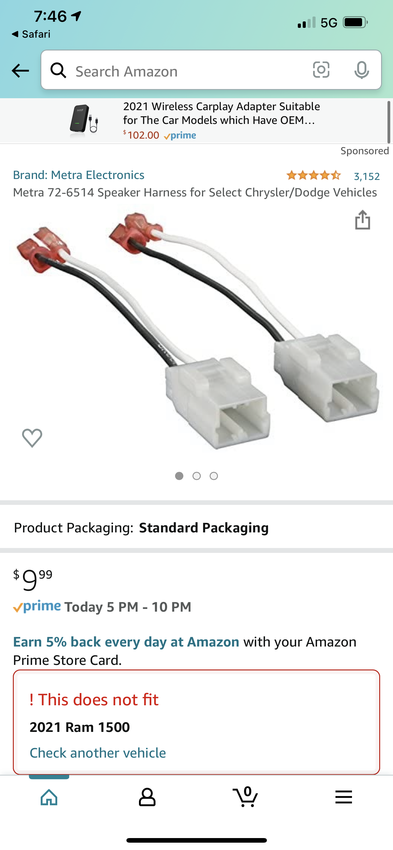

Sweet thanks. So I don’t need that metra brand connecter that’s in the pic I posted?

I have a 2019 and that is what I replaced my front dash speakers with and they dropped right in. I did not like the sound at first but after some tweaking of the equalizer they sound great.
I did all three too and very easy. The metra connector is needed for the 6x9s in the doors if you are replacing them.
Gotcha I’m only dooring the dash ones right now so I can take them out. Thank you
