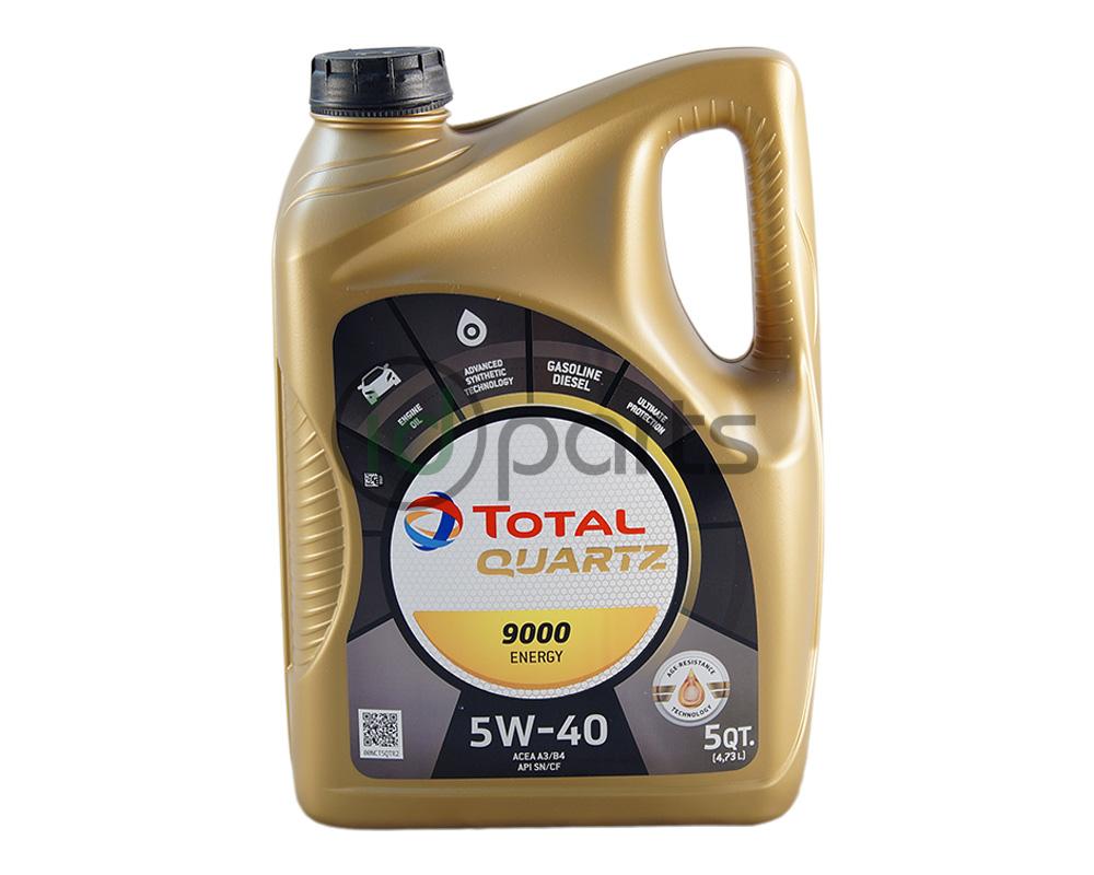

I've been buying my diesel oil service stuff for nearly a decade from IDParts. Looking there, their standard kit for the Eco-D has Total Quartz 9000. They also list Penzoil euro, and Fuchs titan super syn. The kit is 129.99. That's expensive AF. My TDI kit has 6L of oil and is only 50 bucks, and that oil isn't cheap. Where the hell is the price coming from in this kit, the filter? ID parts usually has great prices and service but 130.00 for a kit is painful.
To me, the mark of a great oil for this engine, if you are concerned about ash load, would be anything that has the MB spec 229.5, BMW LL01, VW 505 and espeically 507.
These oils are like 30 bucks a 5qt jug. Is the filter for this truck THAT expensive? Holy hell. ETA - Just looked up the filters online. 50 bucks for an oil filter. The ridiculousness marches on, I guess.

Total 9000 meets that spec.
I've used total Ineo for years in my TDIs. As well as liqui moly and rowe.
I'm not sure how Total 9000 compares to the Penzoil. I'd have to see how many specs side by side. ID parts is definitely high on these kits. The Total 9000 might be a good buy however.
