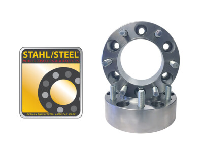

Dodge Ram 1500 1.25" Wheel Spacer​
STAHL STEEL Wheel Spacers - From the same company that produces BORA Wheel Spacers! Built hub and wheel centric to create a perfect fit. This spacer will set the truck up just like a factory set up ensuring a perfect ride. Machined to spec in our Reno, Nevada factory - 1.25" thick with 14x1.5 studs, a 77.8 hub bore and a 6x5.5 bolt pattern. Lug nuts to bolt spacers to the vehicle are included. These spacers come with a lifetime warranty. Made in the USA.​
For those of you who are looking for a cheaper option, while not wanting to sacrifice safety there are other options besides Bora. Bora is probably the most well known and they offer both aluminum and steel.
An example for cheaper options is KSP which are forged hubcentric rings at about 1/2 the price.
