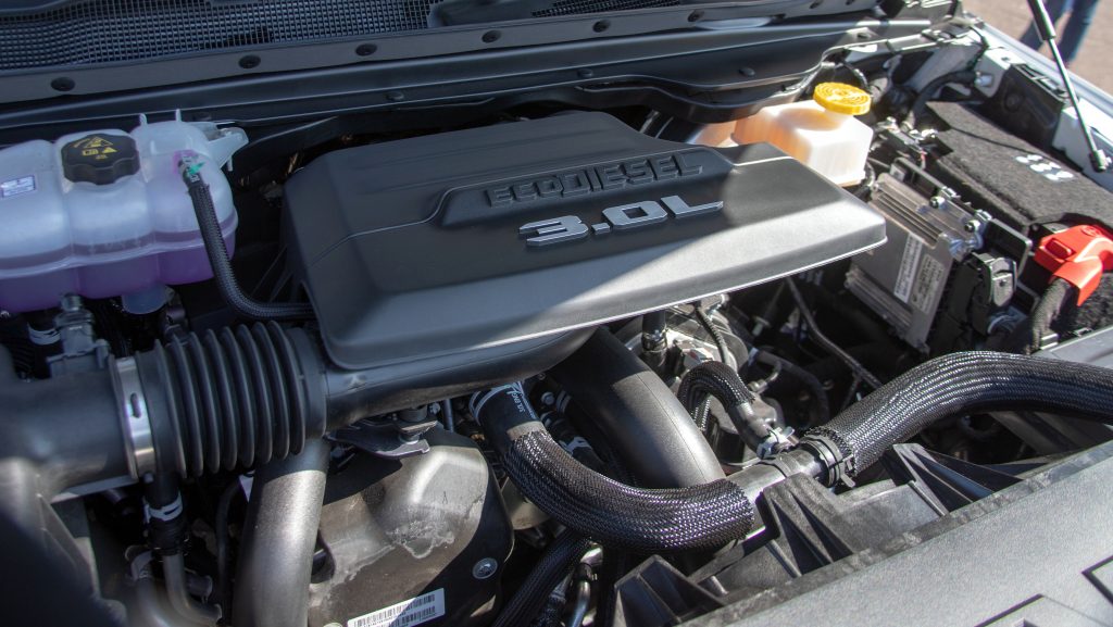

What is involved in changing the HPFP in these trucks?
Does the engine have to be pulled, or can it be swapped in situ?
Its right on the front of the engine, upper right side, follow the thin metal pipes that are the high pressure fuel rails.. Engine shouldn't need to be pulled, but they are gonna have to take a LOT off to get to it.
