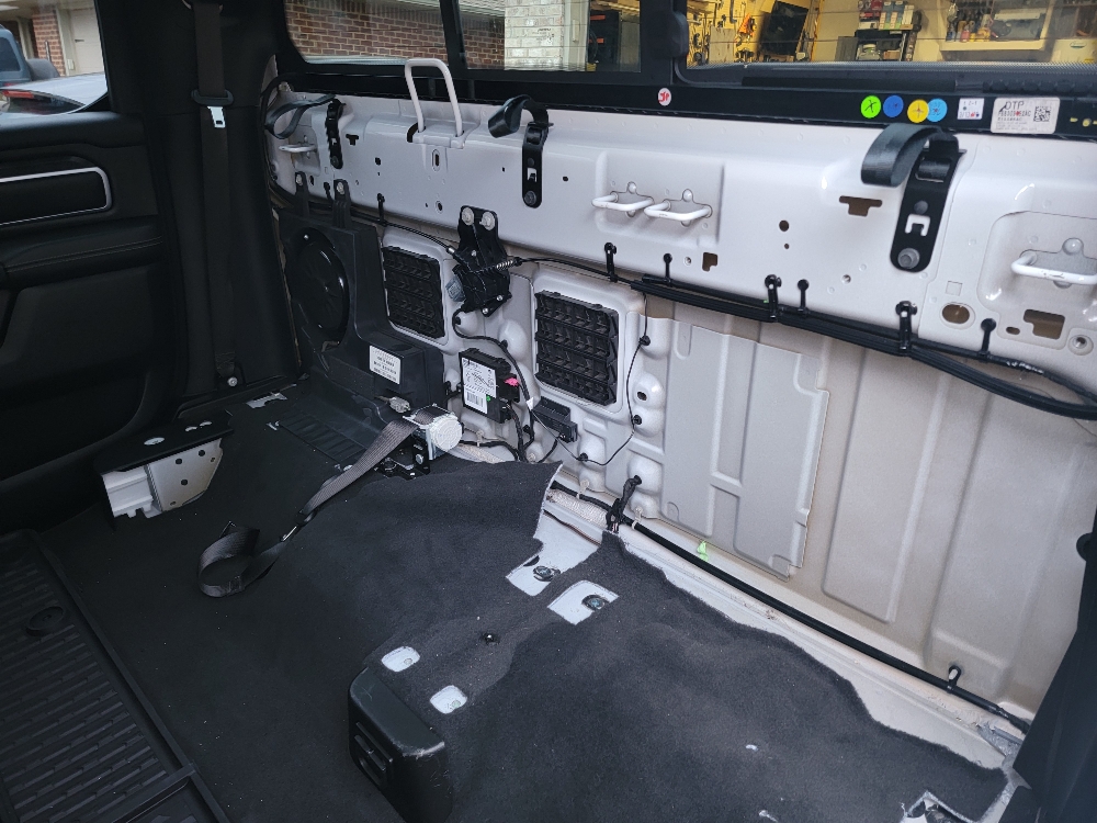

I have had my backseats removed now for over a month. Probably gonna leave them out. made it easier to load my stand for my go kart when I take it to the track. The noise doesn't bother me. But I also have a leak somewhere back there and thought it would be easier to diagnosis it with the back seats out.Dropped my truck off to get the window replaced tomorrow. Say a prayer for me that they don't screw anything else up in the process. Hell I even removed my freshly katzkin'd seats and trim panel for them.
As soon as I get it back, I'm going to leak test and then sound deaden the back wall and floor.
It's insane. How much noise comes from back there. On the way to the dealership it sounded like my rear window was open.![]()
