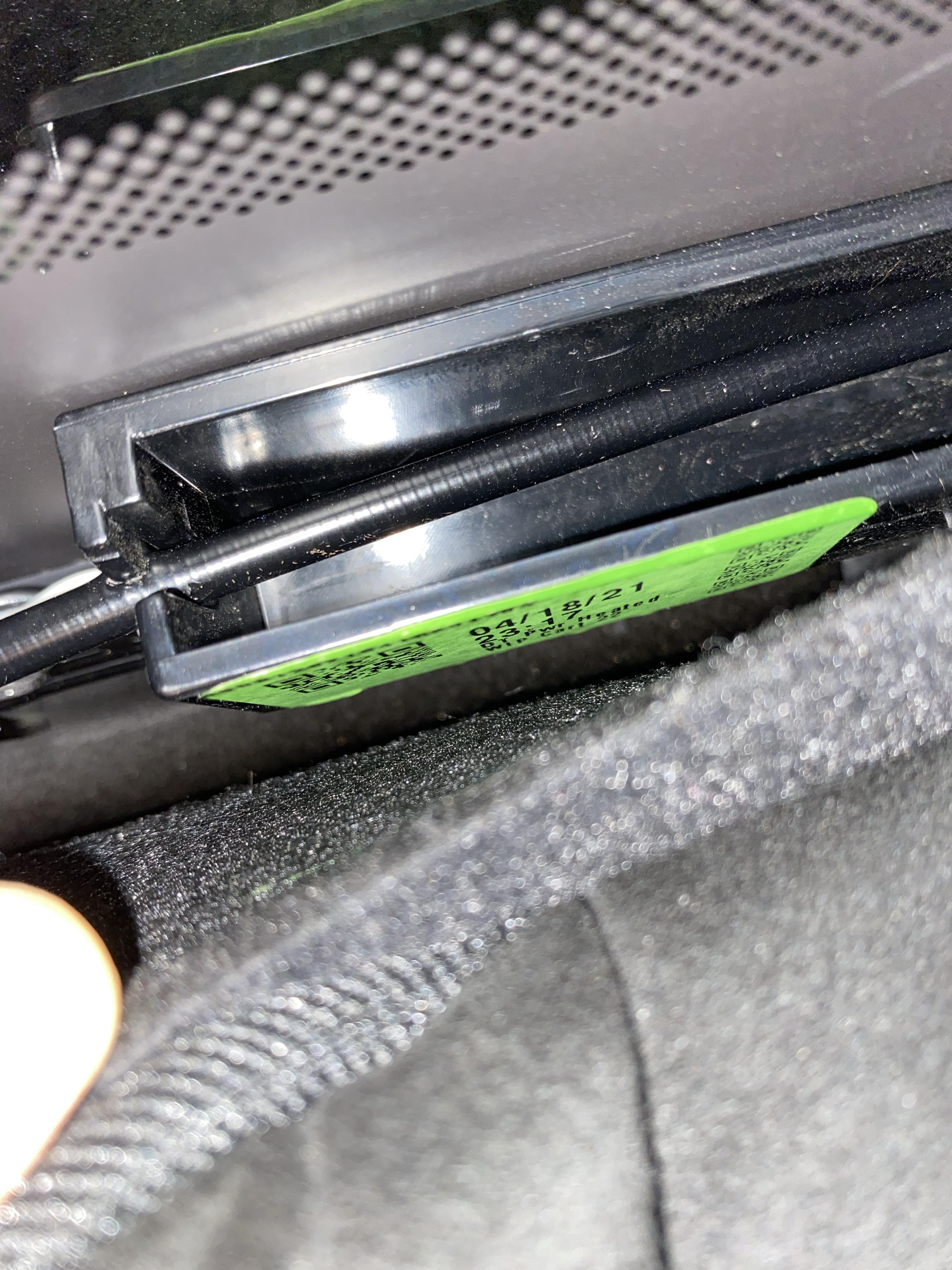

Looks like you could have two problems, cracked frame and a leak either from high mounted brake light or the shark fin antenna, most likely the brake light.
