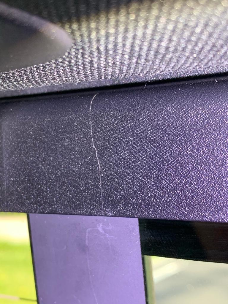

I’m joining the club. I noticed water on the plastic window frame and the headliner and the seat back were both wet on Monday after a good rain. I shined a flashlight on the area and the crack really stands out. It clearly runs all the way through the plastic from the bottom all the way up and behind the headliner. The truck goes in for water penetration testing at the dealership on Tuesday. I only have 7500 miles on the truck.

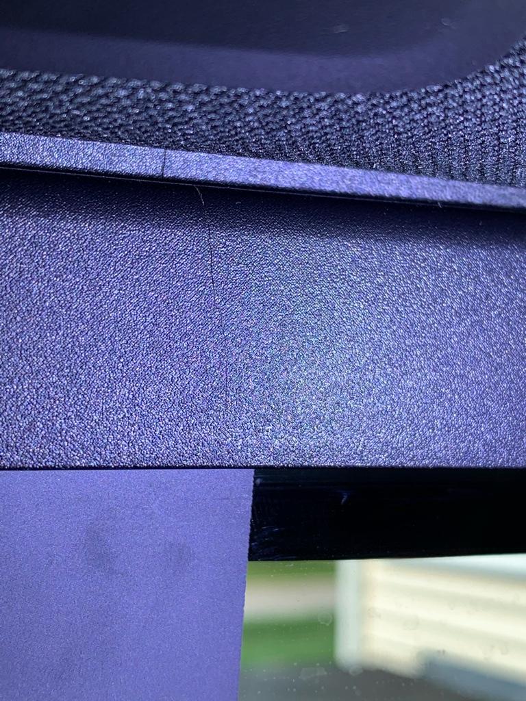

Here’s another angle. You can see it go up behind the headliner.
