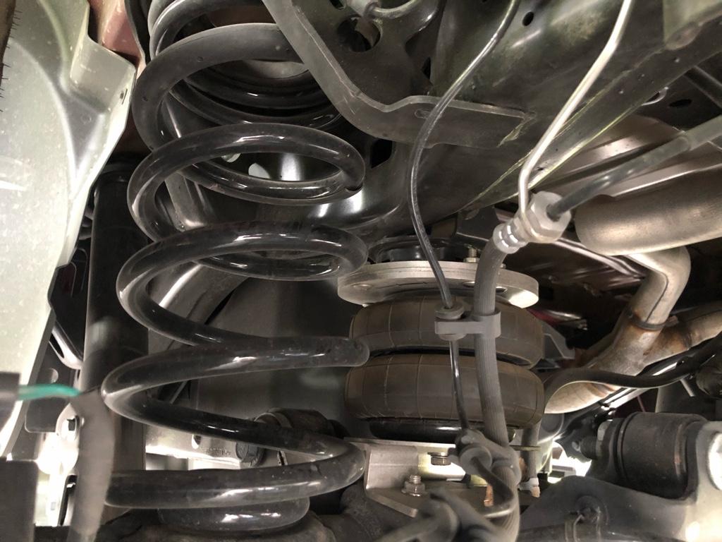

blakei
May 30, 2020
78
80
Agree that the WDH is a must, but still had some sag so I put in the Timber Grove bags. Love the bonus of boosting the truck up to help with hitching.
Here are some photos of bags installed. The air line is routed around the spare tire and tucks into the bumper cover near the hitch. Easily accessible and out of sight. I use a small battery air compressor to inflate.
