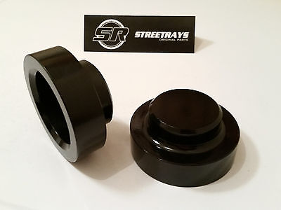

I recently added a MotoFab 2” front kit, and my truck is almost perfectly level, there is like 1/4-1/2” rake. If I put anything in the bed I lose the rake. With my camper and WDH hooked up I’m still too low for my liking. I’m adding a 1” spacer for the rear that should be here later this week, I think it will put me right where I want to be. I didn’t want much more than a 2 “ lift for the front and decided to just slap the $35 MotoFab top hats in until Bilstein ones out with something.
This is the rear spacer I ordered that another forum member used and it fit just fine.
Did the 1” spacers end up working for your 5th gen? I also want to raise the rear 1”.
