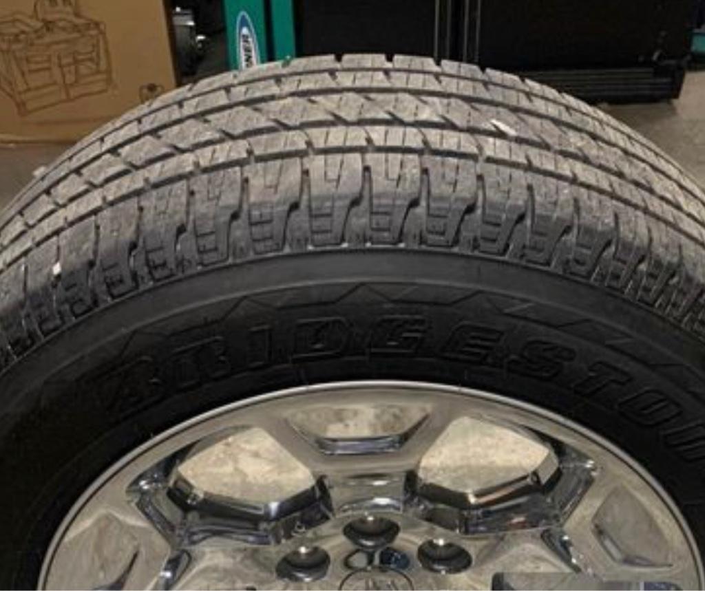

Thanks guys. Gonna find out how good my tires are in snow this weekend. Falken H/T02's, very few people seem to have these, especially in my size. But the reviews I did find were really good, it's still an H/T tire, not even a "light" A/T (like a Cooper AT3 4S), but it seems to be one of the toughest H/T tires out there, and one of the best in snow. I think they're trying to compete directly with the Defender LTX, at least in the light truck segment.
edit: sick looking sidewall for an H/T tire too.
If I had to guess, the same as the stock tires since it’s almost an identical tread design.
I’ve not had issues with the stock tires, as long as you realize you’re still going to slide a little
I mean, they're both still H/T tires but the treads look pretty different to me. Not sure how much difference it will make on snow specifically but I've gotten better grip on dry and wet so far.

I meant the Oem Bridgestone
See, if my truck had come with those I probably wouldn't have changed them right away haha.
Scorpions are not bad tires but their tread and construction clearly was never meant to try and handle the weight of these trucks. Or even a JGC for that matter. They were great on dry pavement and did fine in the rain but were absolute garbage on snow, and with the little bit of off-roading I did.
The Falken's have done better with all of that so far, except I don't know about snow yet.
