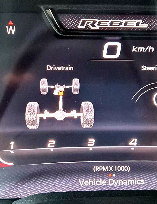

2) is it normal that the yellow sign "axle locked" is always on, in every mode (2wd-4Auto-4High ecc..) ? ....see photo.
The first question is to understand from the owner's manual, but I haven't found anything about the off-road features of the Rebel X 2025 version.

Hi to all !
I have two questions for the Rebel X 2025 owners:
1) owner manual consist only in "owner handbook", "quick start guide" and "consumer information guide" ?
and also
Thanks everyone for the replies.
in 2wd it shouldn't show as locked.
@boogielander , I think the same thing too.
And also, shouldn't the differential lock control (which is unique) lock only the rear?
Instead, I think this truck also has a front lock... maybe for the X version of the Rebel only.....
Today I'll ask to the dealer for clarification (I picked up the truck yesterday).
Rebel X my2025 - 3.0 SO
Inviato dal mio SM-F766B utilizzando Tapatalk
no rebel x doesn't have front lock.
none of the 1500s have front lock.
front lock is only available on 2500 power wagon.
and you're right the lock should be in the rear... i think.
i haven't really paid attention to mine (i have a 22 so no digital dash like yours)
maybe just a glitch
@boogielander , Thanks so much for the clarification.
So if even a Rebel X RHO (if it exists...) doesn't have it, it should just be an electronics issue (perhaps a software bug).
Updates will follow

I have some news...
But I don't know if it's good or bad
It's not the front differential that is locked, but the CENTER differential.
Driving 2WD, this situation could also be normal, but I ask myself:
"If center differential were unlocked too, wouldn't the truck consume less fuel?
What about the Ram Limiteds that have a lock ? - Who knows this thing ?"
Thanks

I have some news...
Thanks
center diff locks are found on all time four wheel drive vehicles (ie, landcruisers)
if you have 2WD, there is no center diff. you only have transfer case and that is only engaged/ locked when you shift into 4WD.
if you see 4WD-Auto on your transfer case selector, that means your t-case is engaged/ disengaged via a CLUTCH type of connection when in 4WD-Auto.
@boogielander, I've read your clarifications. Thank you. They match whith mines (with Nissan Patrol, Toyota BJ, Land Rover defender).
My reasoning is that WHEN the truck is in 2WD, the center differential lock should be off (grey and NOT yellow and closed like in the photo I post here at th taken in 2WD !!).
Central Diff: LOCKED (yellow)
Rear Diff: UNLOCKED (grey)
For me in 2wd is wrong, but maybe that the wrong is me.
I don't know, I'd like to understand..... we would need a ram rebel X user (2025) to look at the off-road page on the display (in 2WD).
yeap that's exactly what i mean.
i think it's a software glitch.
I played with the settings last night. When you engage the rear locker the rear light comes on but the front one as shown never changed regardless of which 4wd setting I put it in. Would agree a software glitch or it means something none of us know.....
checked mine.
in 2wd center diff lock icon is in unlocked position.
I went back in and looked again It shows locked on the digital display but when I go to the off-road pages on the center screen it shows unlocked and responds to each transfer case change accordingly
yeap a glitch for sure.
try unplug the battery for a hard reset see if goes back normally.
