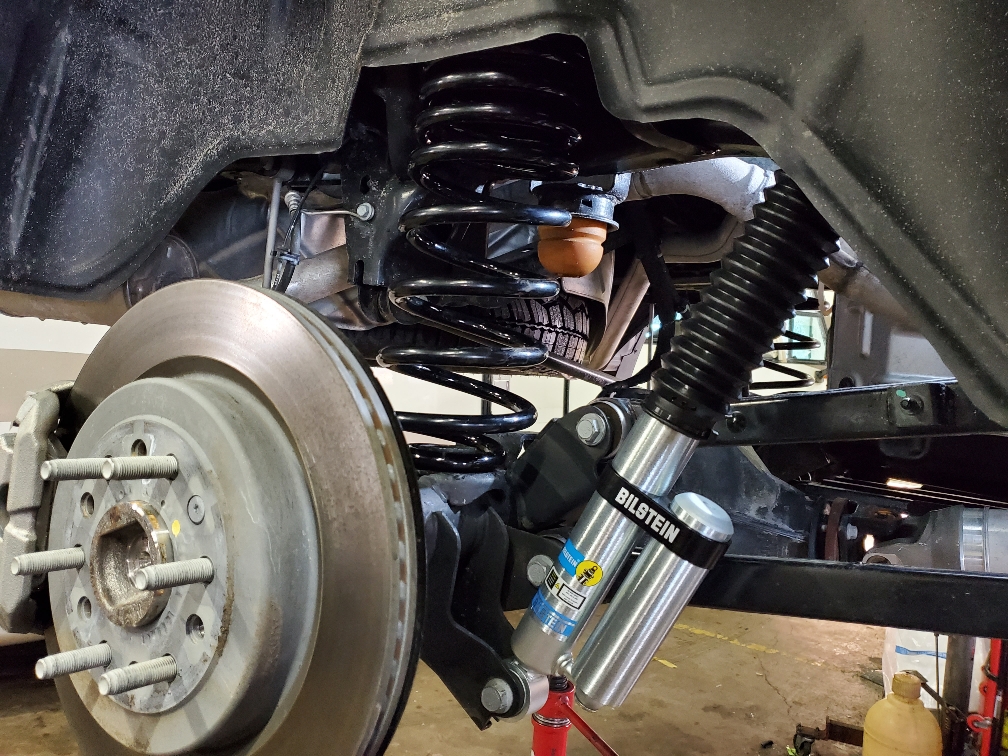

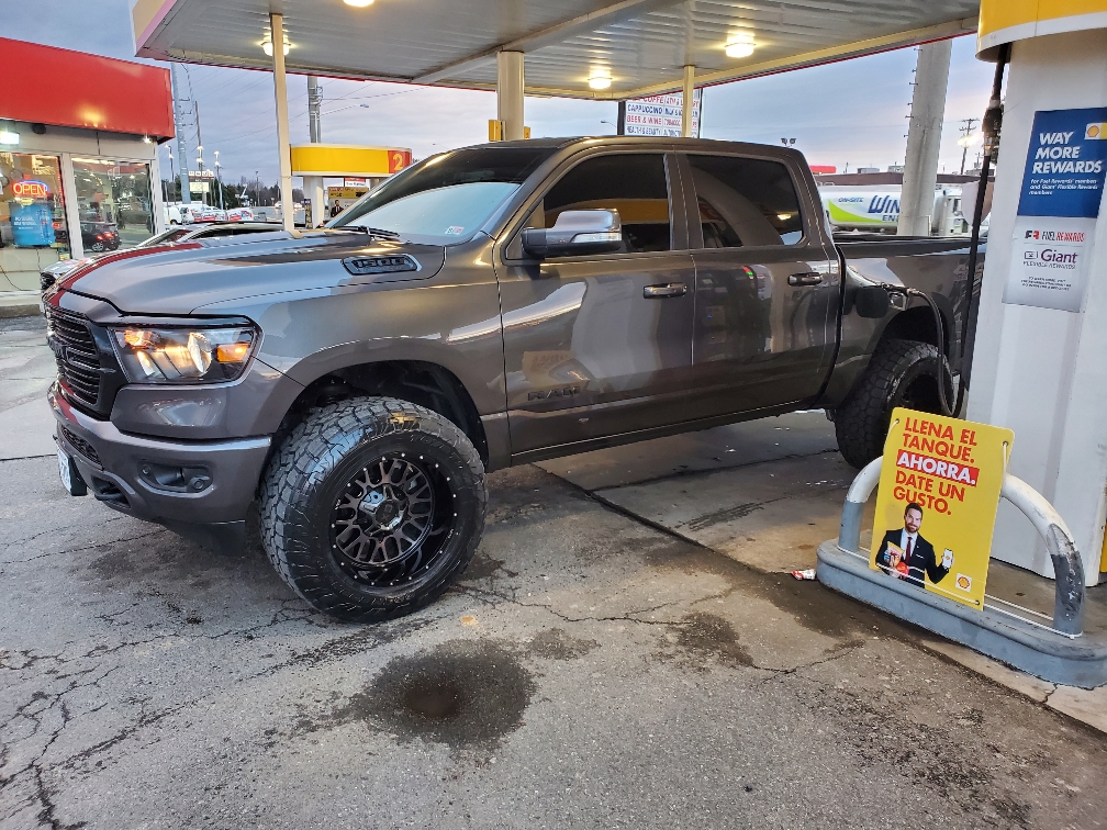

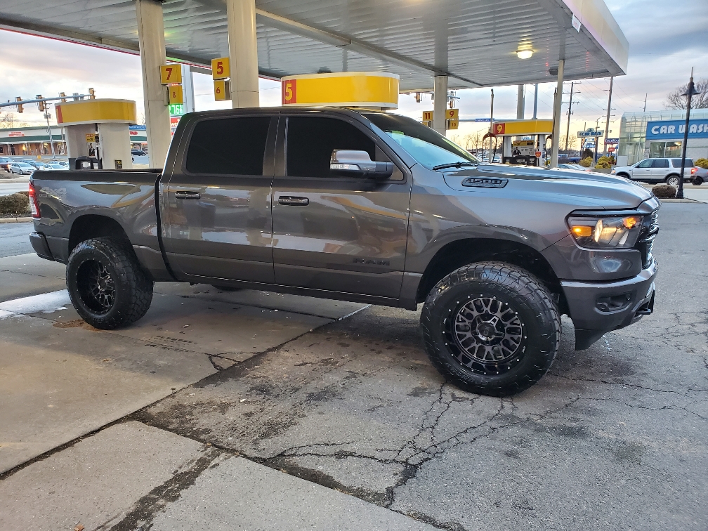

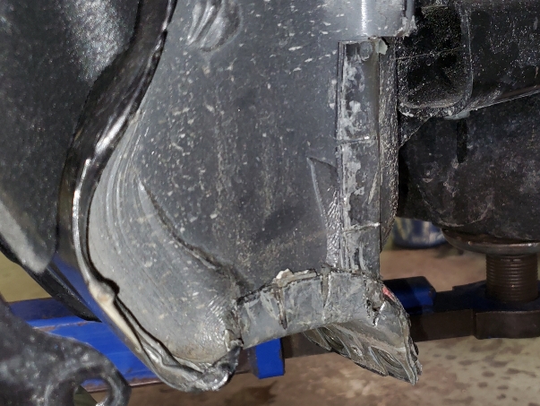

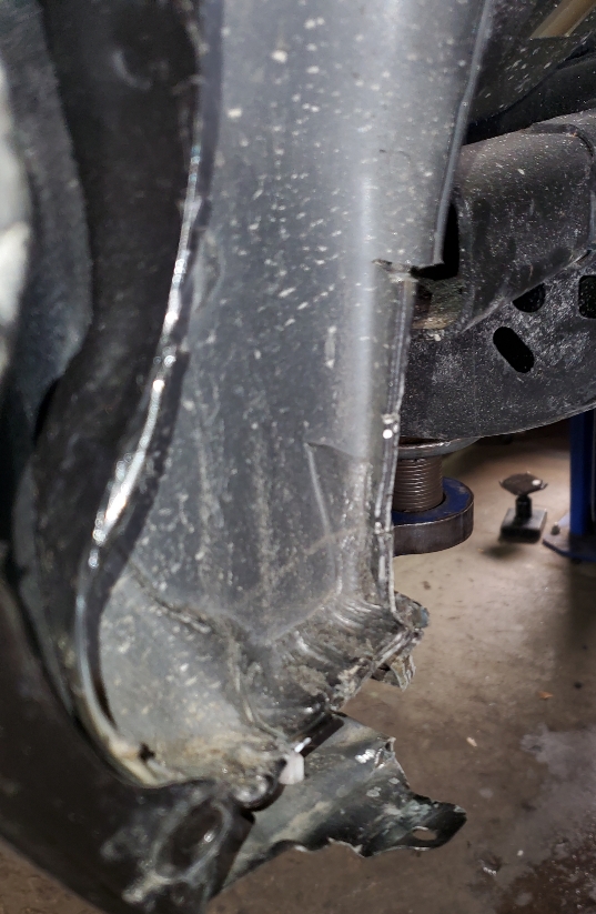

Got everything installed recently and a couple hundred miles down the road. 2020 ORP BigHorn

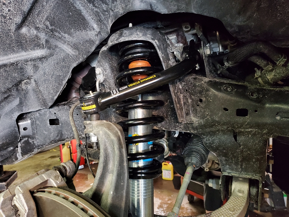

6112 (8th Clip) setup with Icon UCAs
*+ MotoFab 1/2" Strut Spacer*
5160s in back with Clayton Springs and Hellwig swingarm.
Toyo AT3 325/60 r20 (35.4/12.8)
- Tires are too big for this setup but we did a full NorCal tuck and made it work.
Truck handling is substantially improved on and offroad. Definitely slightly stiffer compared to stock but not uncomfortable or noticed by my wife which is bonus. Haha
Couple things
-Clayton Springs put the truck at a 2" rake with just the 6112s. After adding 1/2" strut spacer, she sits how I intended and with 1000lbs of shingles in the back (roofer) it sits level and drives very nicely with the triple rate springs.
-Ordered my wheels through custom offsets with new TPMS (non oem). It's becoming a bit of a hastle as they did not come with product info and my shop has not been able to program the sensors. Ram wants $280 to dismount, view product codes and "clone" or encrypt the sensors to the OEMs. I believe we can get this worked out as custom offsets is providing proper product codes (UNI) and saying it needs a specific ITM programmer.
-Ram calibrated the speedo for the oversized tieres. This cost $200 for the programming. With that being said the park sensors no longer work. This is a known factory issue and they are waiting for the system update from factory to correct it. Not a big issue for me at the moment. Speedo works.
Other than that stuff install was simple. Very happy with the performance and the look.
