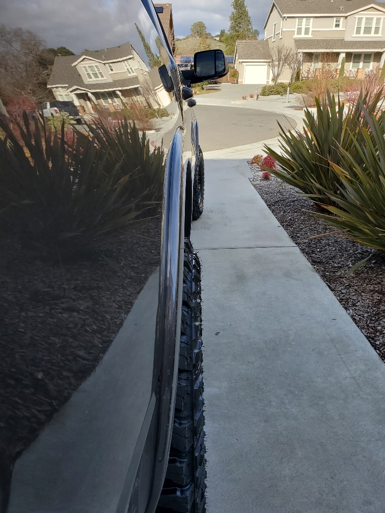

Got the 6112 (clip 8) and 5160's installed (along with rear spring and UCA). I use this to tow so wanted half - 1" of rake still. Put the new wheels and tires. 295/70r18 fit. Had to remove small front mudflap and bend back metal bracket, then put the factory mud guard back on.
Super happy so far with the setup.

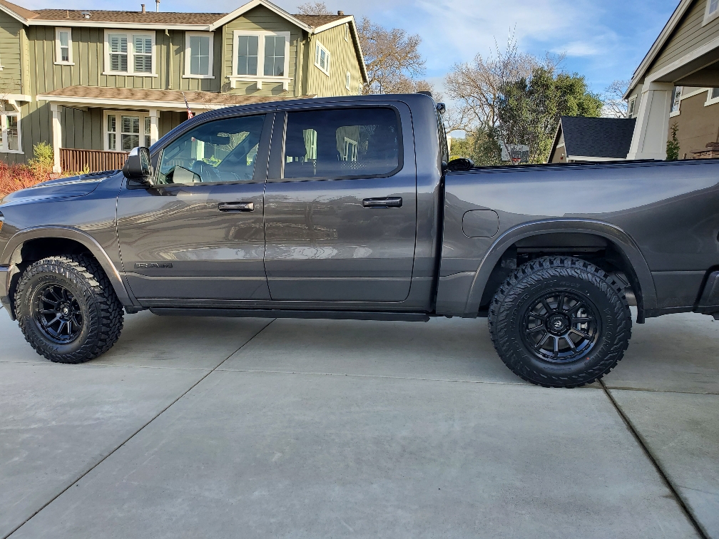

No additional lift. Just a higher quality shock. I changed out my rear coils in the rear to get additional lift. I have a bed slide mounted in the bed that weighs a bit. With the 2” lift in the front I was a bit nose high. And then when I loaded up, the rear was much lower.
The new coils gave me rake I wanted. So I’m up about 2” front AND back.
