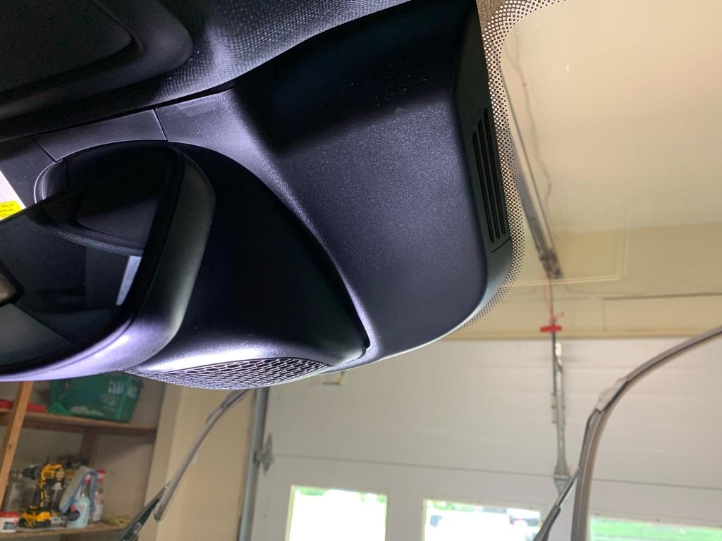

Got around to the install today. Super easy to get off the shroud and cover with the instructions posted in this thread. Was only able to snap a few picture because I was in a rush. Hopefully these help anyone looking to do it. Installed a APEMAN front and rear dash camera to it and powers up no problem.
I'm glad this worked for you. Where did you decide to stick the cam and route the wire? The orientation of the oem connector facing towards the driver is unusual as this interface usually faces towards the front of the vehicle on every other brand.

I just tucked it behind the mirror you can see it I’m waiting to get a shorter wire and the camera I used (apeman) has a rear camera I need to install as well so once I get the short wire I’ll tuck everything in there nice but there is SO much room under that plastic plate if you take your time you could tuck a few cables in there if needed
