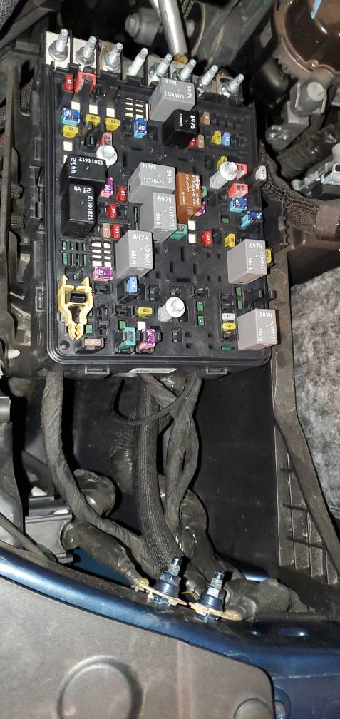

I was able to get the wiring as you know. I finally got the module. I'm still missing the grey connector. No luck finding it anywhere...I was able to get everything installed and was able to rig up the connector. Once it was all "hooked" up they still don't work. I think the problem is the 12v source from the fuse box. I have some questions on that part of the install for you. When I installed the wire in the connector under the fuse block it didn't connect to anything on the block??? When I probe the wire I get no voltage or a very low, less than 1V, reading. Could you take a pic of your fuse block for me? Just with the lid off, not disassembled. Does any of this sound familiar to you?

Oh man sorry to hear that man, I could but the wire comes from the buttom of the fuses. So I would have to dismantle everything again. I think it's a trigger wire connected to tell the steps the door is open and close. Shouldn't carry high voltage so that would make sense why it doesnt work. I took the picture to show you.

Well I’m an idiot! I installed the red wire in the wrong connector on the fuse box. Fixed that and boom. They work like a charm! Sometimes it’s hard being dumb lol.
