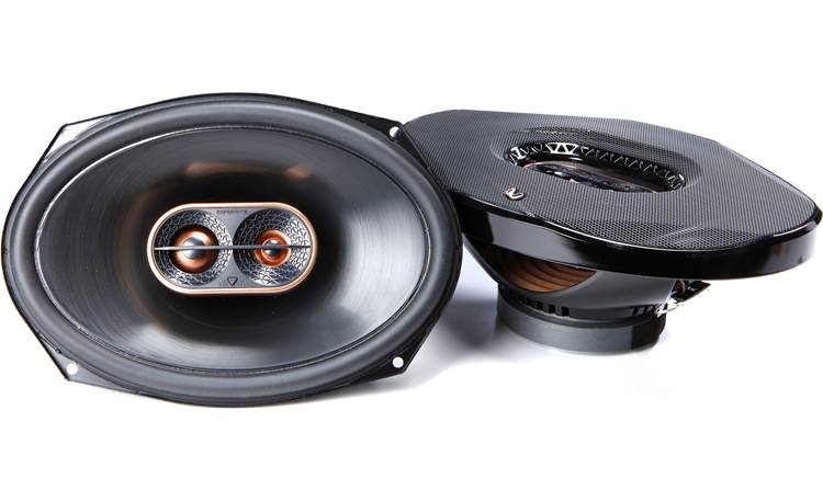

I have the none alpine version. Question are the front/rear speakers components or tweeter/mid/base?
Can you replace the front/back with a three way if the factory wasn't a three way and will it cause issues?

You can change the speakers no problem... change the dash speakers too to some nice infinity 3.5s and believe me, you gonna be impressed.
Start with the dash speakers because they are the easiest to swap and then if you like the way the system sounds, continue with the door spkrs. Some people don't like the sound of the AM speakers so that's a good way for you to know if you like the extra loud and crisp highs...
On the base 6 speaker system you get a full range signal on all of the speakers. So you can use two or three way speakers for every location.

I replaced all 6 speakers with Infinitys. I did the dash first and while the sound was great, it was very overpowering at first due to the speaker's lower resistance and higher sensitivity. Fading the audio back to the rear a notch or two helps.
For both sets of 6x9's I went with the 2 way speakers. There is a button on the tweeter portion of each 6x9 that gives a 3db boost to the tweeter. I turned this off on all 4 speakers. In hind sight I could have left it on for the rear 6x9's. The front gets enough highs from the dash for my taste, so I wanted more bass from the 6x9.
Last thing I did was add the resistor from Infinity to the dash 3.5's. In the stock 6 speaker setup all speakers receive a full range signal as previously mentioned. Whenever I cranked the volume it seemed like the 3.5's were really struggling trying to hit the bass notes and I thought they may blow.
All in all, its a night and day difference from the stock set up for not a lot of work. The 6x9's wont give you any"bump" but do have a good bass.

If you want to turn the boost on in the back, you can try poking it through the speaker grille.
Adding the Bass-Kill resistor was a good advice. @busa2009, you should do that too.
