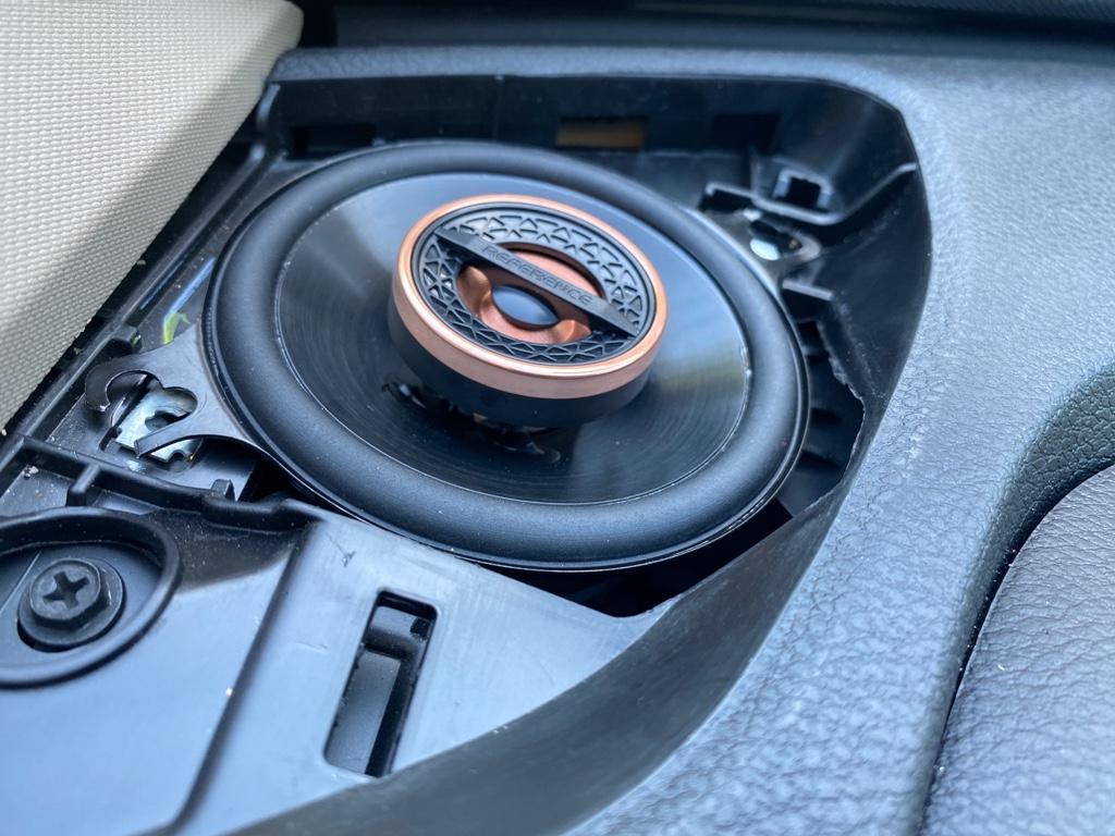

If anyone using these 3.5 you going to have to clip them a little to get them to seat correctly
No you don't. Work harder at it and maybe rotate it 180 degrees. I've installed those in 4 trucks and never clipped a damn thing lol.
There is no problem in changing the speakers. Just try to change the dash speakers too to some nice infinity 3.5s and believe me it will be a crazy upgrade.
