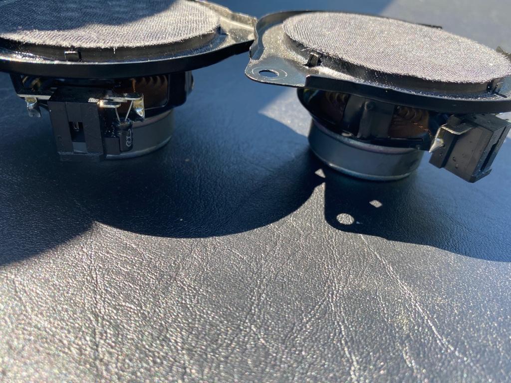

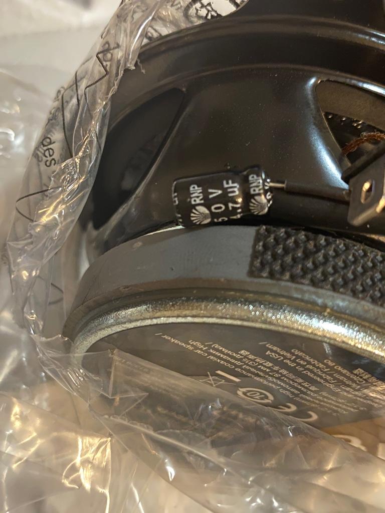

Does this need a resistor? It looks like one is already there

I don't think that's it. I can't see how it's connected but the bass blocker has to be plugged in line with the positive terminal.

I believe that is the crossover capacitor for the tweeter in your coaxial speaker. You’ll need to use another capacitor to cut off the bass frequencies for the mid range driver.

That is a capacitor being used as a high-pass filter for the tweeter.

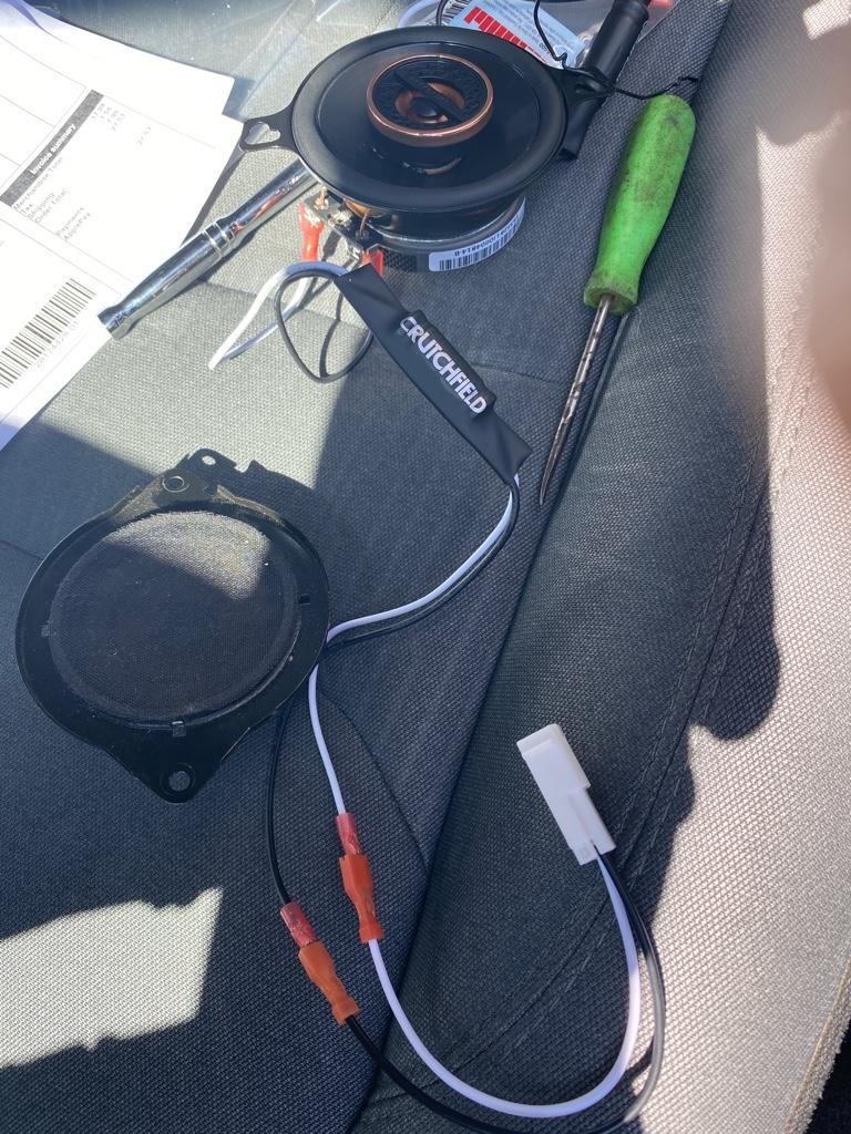

Ok I got it. So I need to put a resistor on the positive side. Is there a certain resistor I need or go on crutchfield and see if they offer it

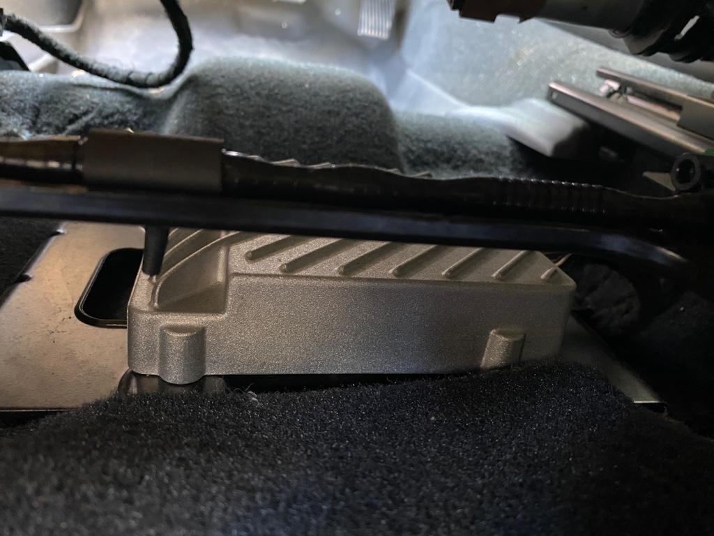

WAIT!!! You have the HK system???
When you said non-alpine, i thought you mean you have the base system...

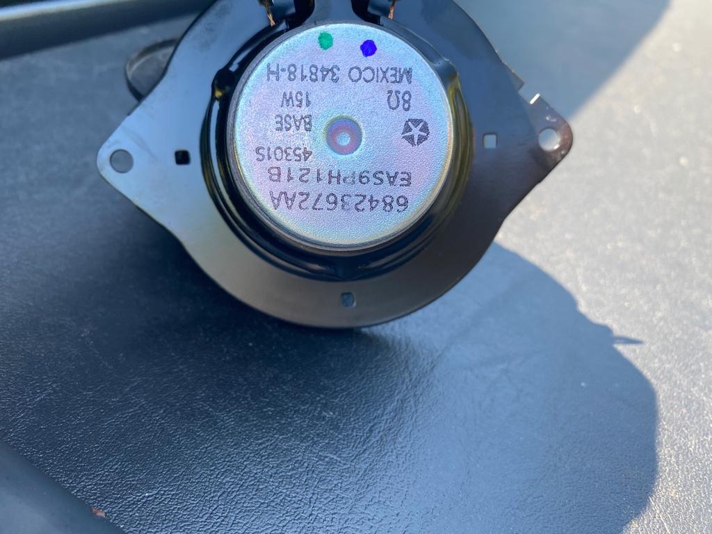

Hmm have to look at my sheet but these are the speakers that came out and this is what’s under my seat
