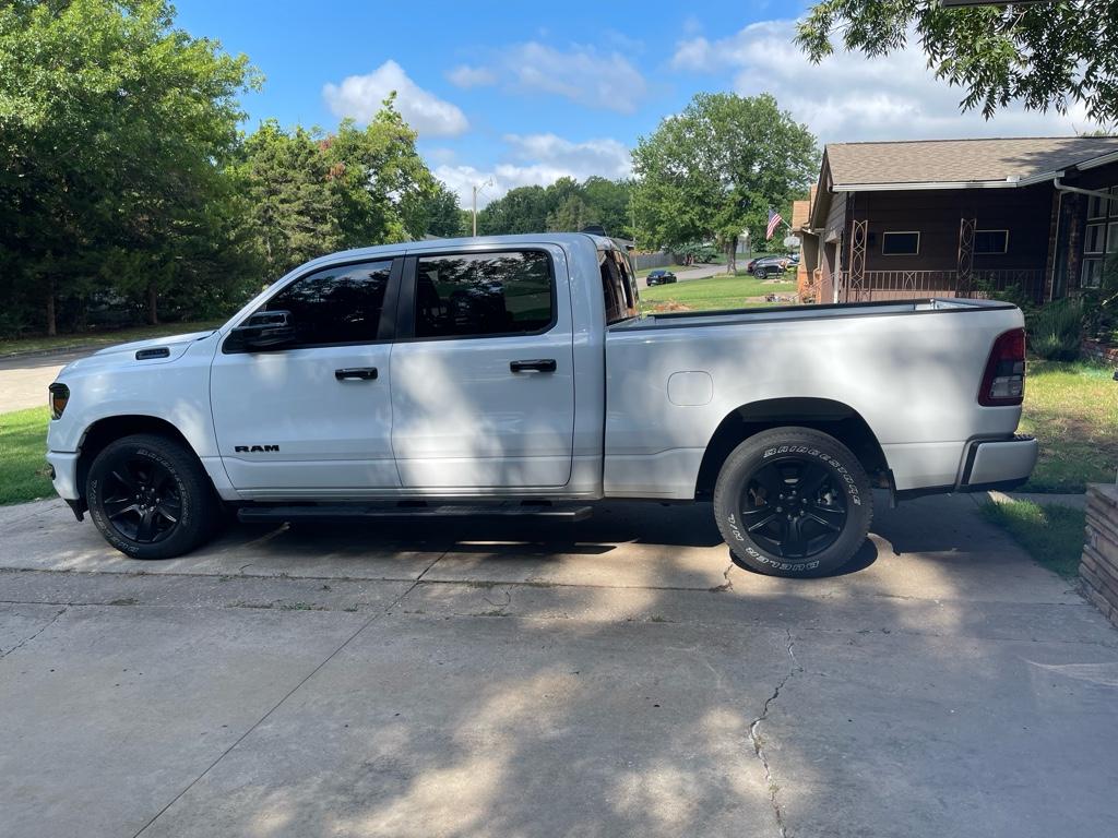

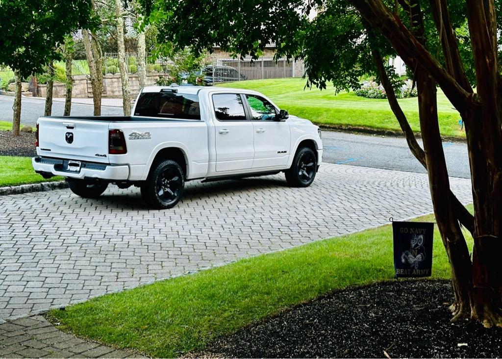

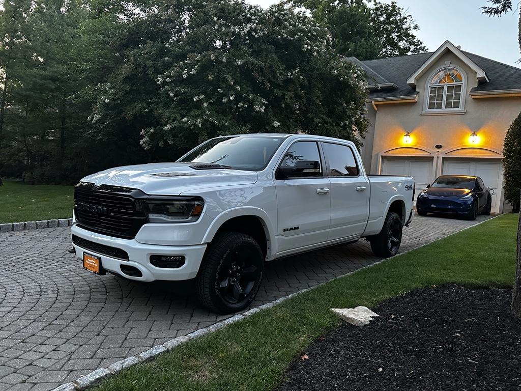

Picked it up yesterday! Love having a full cab and standard bed! Upgraded from quad cab with standard bed.
