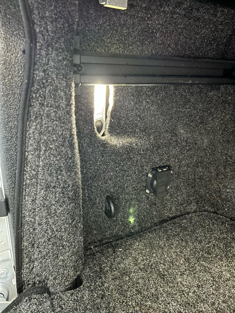

@kosmos66 -- I ran the constant power wire along the frame body harness under the truck... it's in a protective mesh loom and it's zipped tied.
The new wire is protected by a circuit breaker...
-=FM45=-
CURT 56070 7-Foot Vehicle-Side Truck Bed 7-Pin Trailer Wiring Harness Extension, Select Chevrolet, Dodge, Ford, GMC, Nissan, Ram, Toyota , black https://a.co/d/j2jmhr4
Took about 30 mins to install. So simple and a clean look. Needed 12v for a large 12v cooler. Usually have my travel trailer plugged in the bumper. Now I can run both.
