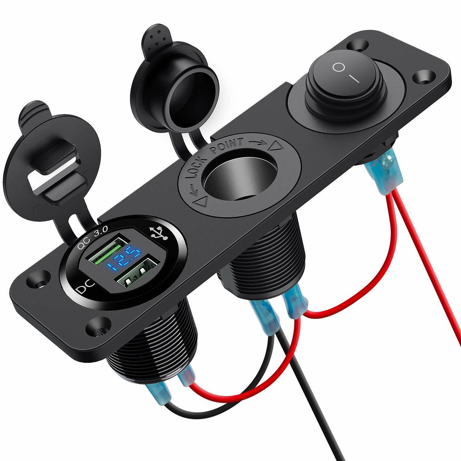

Where is everyone putting the 12v in the bed?
pics please!
zlman
Jan 11, 2020
139
109
I like the power box, where did you find that?
I've got this one ordered.

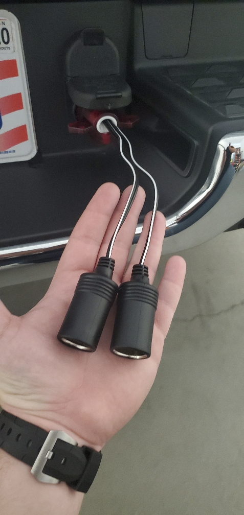

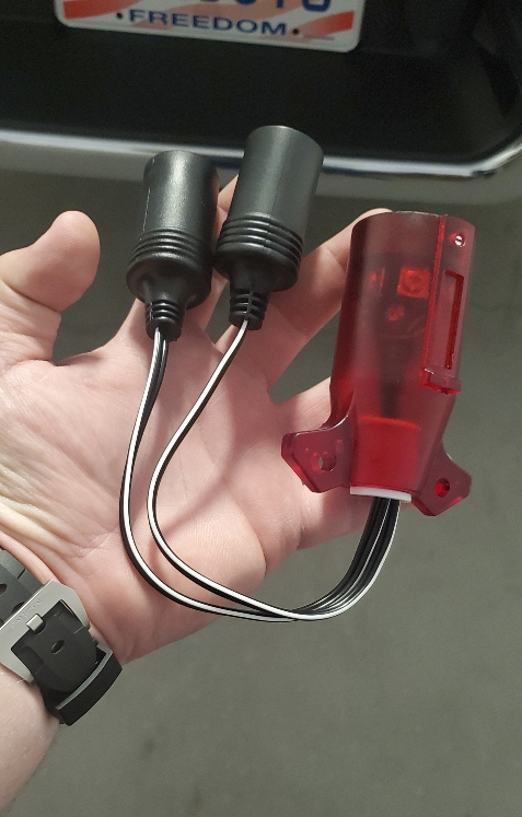

Haven't done it yet but I plan on running a Curt 56584 adapter wire up into the bed and connecting it to the junction box pictured below, so I have power for the bed, bed lights, third brake light on cap, after market reverse lights, and any future additions. I have all the parts just waiting to hook it up.
zlman
Jan 11, 2020
139
109
Did this end up working out? Looks like it would be pretty close to fitting in the OEM bed light spot.
Works great, 3+ yrs now. Not sure if it would fit in OEM spot, I made a bracket, attached to my topper mount.
