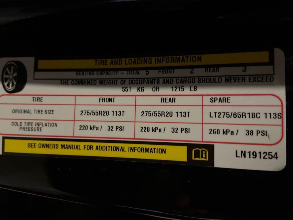

Please post your Tire and Loading sticker
2020 Laramie 1500 Crew Cab 4x4 5'7" bed
5.7L V8 eTorque
3.21 rear end
18" wheels
Equip Level 1
33 gallon tank
5 seating
RamBox & MFT
Bed Utility & Tonneau Cover
Wheel-to-Wheel side steps
Sticker Payload Capacity: 1158 lbs
Sent from my Pixel 3a using Tapatalk
5.7L V8 eTorque
3.21 rear end
18" wheels
Equip Level 1
33 gallon tank
5 seating
RamBox & MFT
That’s got to be one of the heaviest Laramies on here... @devildodge can confirm.

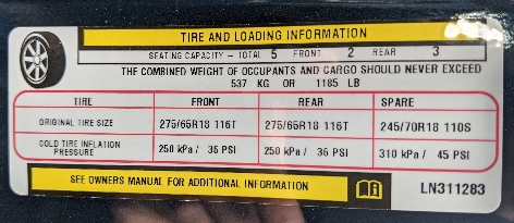

i was researching some inventory of 2020 Ram 1500 Limiteds. And I found at least 3 in below configuration. When I looked up their payloads it says 1840 lbs for each one of them !! is something amiss here?
2020 Ram 1500 in Limited Trim with below options rated at 1840 lbs payload:
Off Road Group
Limited Level 1 Equipment Group
3.92 Rear Axle Ratio
5.7L V8 HEMI® MDS VVT Engine
Dual-Pane Panoramic Sunroof
33-Gallon Fuel Tank
Trailer Brake Control
Off Road Group
33-Gallon Fuel Tank
The actual payload will be about 1300 with those options. Contact one of the dealers and have them send you a pic of the payload sticker inside the drivers door.

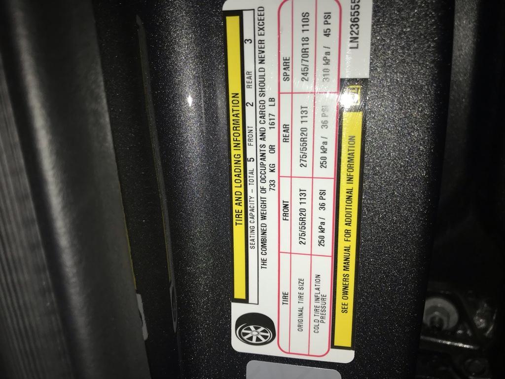

2020 ecodiesel, big horn level 2, 4x4 crew cab, premium lighting, bed utility group, night edition, 9 speaker with subwoofer, rear wheelhouse liners, rubber floor mats and 3.92 gears
1617 payload
According to mopar site 10017 towing capacity (which appears to be higher than I’m seeing for most other ecodiesel big horns similarly optioned)
Dual-Pane Panoramic Sunroof ,Off Road Group ,33-Gallon Fuel Tank , all of these option add a lots of weight
Here is mine. Let me know if you need me to carry some stuff for you!

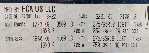

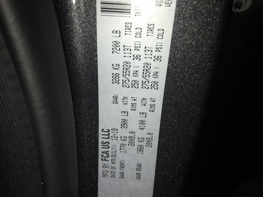

Hi ya... been debating upgrading our TT, which will require upgrading my 1500 too. i’m not touching the 2500 until at least the 2021 model after they make a real 5th gen out of it. That said, I’m trying to locate payload sticker data for a limited crew cab, hemi, tow package, no pano so I can get a feel for how much TT we can actually pull with the 2500. Id rather it sign up for the HD forum at this point, so hoping some of you also have 2500s w/o the diesel?
