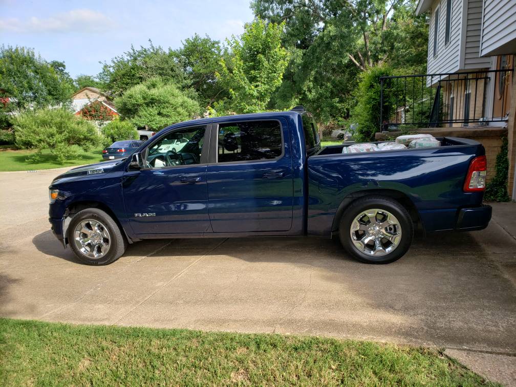

Not the best pic for assessing stance (driveway slopes)...this is loaded with z pallet of 12x12x2 pavers and several bags of sand...no idea what the actual weight was.

This is why I love the self leveling suspension...
About a 1000 lbs of mulch. Zero squat.
