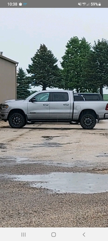

Well update: I just got don't Installing the 2" Mopar lift and took the truck to get aligned. Install was super easy and I am very pleased with the quality. The drive over to the alignment shop, I was very impressed!! It rides better than the stock setup. Here is before and after picture. Kinda of hard to tell the difference but it's there. Thanks for you guys opinions. It made the choice even easier.
What size wheels and tires? Looks good!
Got mine done Wednesday. Since I wanter it perfectly level, opted not to put the rear spacers in. Love the way it rides and its shining spot is railroad tracks and speed bumps.
This meant I might have to go down a tire size, but I’m just looking for a good all terrain tire that’s gonna fill out the wheel wells. Tire shopping this week.
