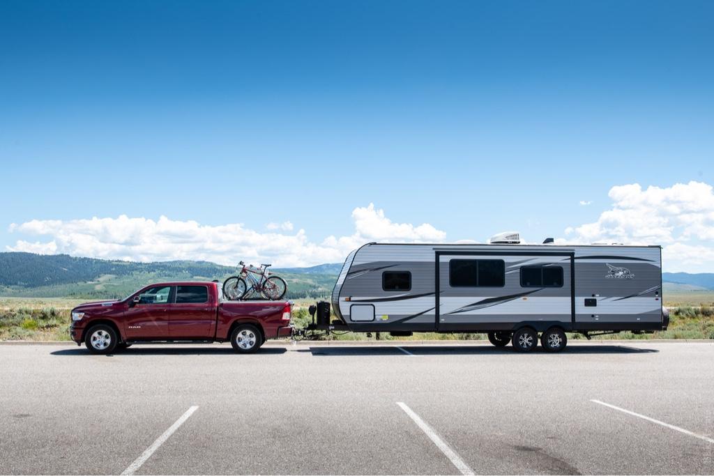

We just picked this up friday driving 1000 miles round trip. Truck pulled it fine, but I need to install my timbergrove bags before I pull it again.

I also have the 3.21 rear axle. So this is good feed back.
I will definitely get the rear camera. I hated being blind with the RV that I rented this weekend.
I'm also looking at the hitch with a weight distribution system.
One more question for you. Do you have air shock system or just stock shocks in the rear end?
Just the std coil springs. I am considering getting the timber grove air bags.
Pretty unique-looking rig there!
Holy hitch weight though! 4970 dry weight with a 1310 hitch weight? The hitch weight alone exceeds my payload!
Jayco 28BHS. 7000 lbs dry, about 8000 lbs loaded. Box is 28’, hitch to bumper about 32’.
Once I load my side by side on it, it'll balance out some of that tongue weight. Then my airbags will help as soon as I install them.
