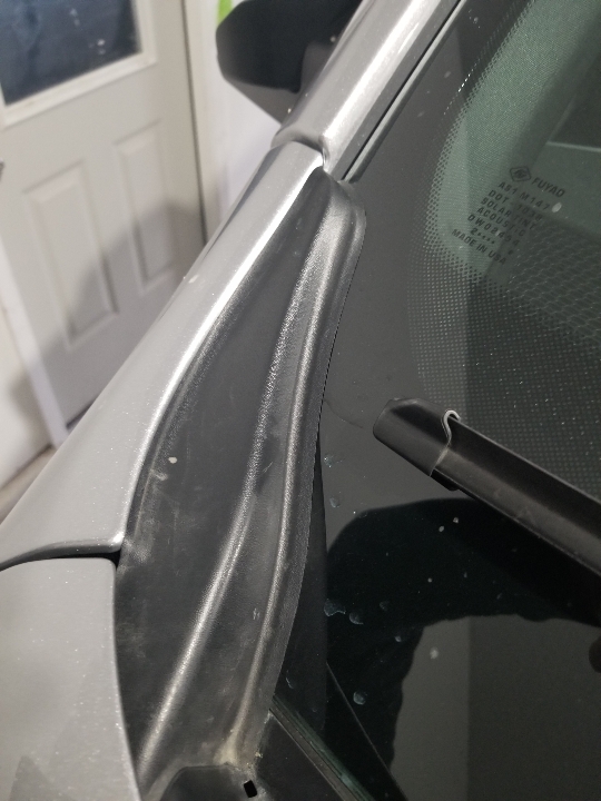

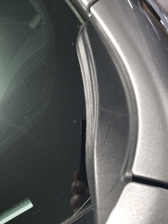

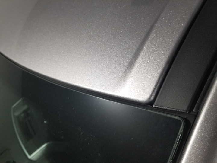

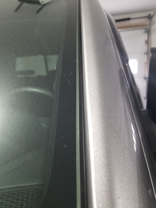

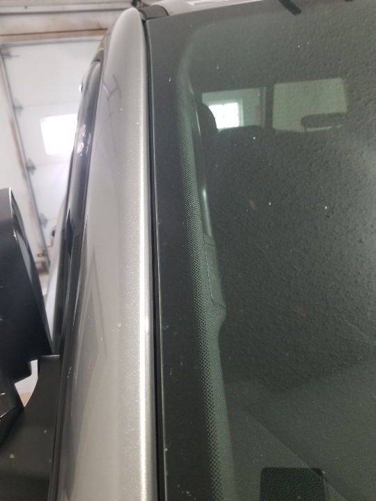

Damn, just went out to double check everything and it looks like he broke one of the windshields cowls, and damaged the other. There's also sealent oozing out which I guess could be normal.
This is what I get for changing glass companies and using who the dealership recommended.
What a dogcrap install.
2023-02-24 14.17.41.jpg2023-02-24 14.11.01.jpg2023-02-24 14.10.42.jpg2023-02-24 14.11.59.jpg2023-02-24 15.01.25.jpg
View attachment 152881View attachment 152883View attachment 152882View attachment 152884View attachment 152885
It pains me to see that.
That's certainly not normal for a competent shop.
That's a hack job.
I just had my windshield replaced a few weeks ago at a local shop that's been around since the 90s.
It looks perfect, the gaps are even, no excessive sealant and no funny noises while driving.
You should give them one chance to make it right.
Then go somewhere else more professional and competent and never go back.

LOL. I refreshed the page and was looking at your pictures for 30 seconds saying, that looks great, what the hell pictures did I even post? Then I realized it was your pictures not mine.
I'm only giving them a second time to get it right because it's an insurance claim.
Then i'm going back to JN Philips, which is Safelite here which I have used for around 10 windshields and only 2 problems, 1 was fixed fine (secondreplacement was put on to line up both sides) and the other I didn't care about the car as I was selling it shortly.
Never had this many problems all at once with a windshield getting put on. Must be a full moon somewhere today.
He didn't cause any permanent damage to my truck, just pieces that will get replaced at least so there's that.
Yeah, it appears they used the correct windshield (M478) but have a slight whistling noise at 70 mph that I didn't have before. Any ideas on the culprit for that?
Put a piece of painters top acrooss the top of the windshield half on glass and half on roof, then test drive.
If noise goes away the glass shop needs to fill the top with a bead of urethane.

Ha!
It can all be fixed, but it's a hassle for you to take it back in when it should have been done right the first time.
Just make sure whoever re-installs it didn't go to the bar before hand. 🍺🥴

Yeah I'm gonna try that tomorrow. The windshield job looks like quality work. Gaps seem to be evenly spaced, no excessive sealant anywhere. I'm questioning if it's even the windshield making the whistling noise. Only a slight, faint, very high pitched whistle from 70-78 mph. Going to try painters tape on the front of the rooftop antenna and see if that changes anything.
Just got it replaced for a second time today. Havn't had a chance to completely inspect it because it's so cold but at a quick glance looks perfect
This time got a tech from the same company that has been doing windshields for the past 20 years and did quality work.
They were going to send the same guy, and I told them no way so they pulled this guy from Boston, so he was extra happy not needing to work there for the day.
He also replaced the 2 damaged trim pieces the last tech broke, and even a missing push clip (didn't notice it until I was removing the cowl myself before he came).
Nice when you meet someone that does good work and is proud of it instead of acting like they work at McDonalds.

Looks like a much better install. How does the gap look at the bottom of the windshield where it meets the plastic trim? My replacement install seems good as well, just noticed that I have a bit of a gap that varies along the bottom. Not sure if that really matters or not. Sides and top all look good.
I'm not 100% sure about the bottom, as I think the trim covers it.
The glass seems to meet the plastic, and I see some spots where it isn't all the way down, but it's kind of hard to explain.
Ill take a picture tomorrow.
As long as it's sealed gaps actually don't matter at all besides bother us. The bottom I wouldn't be concerned about.
