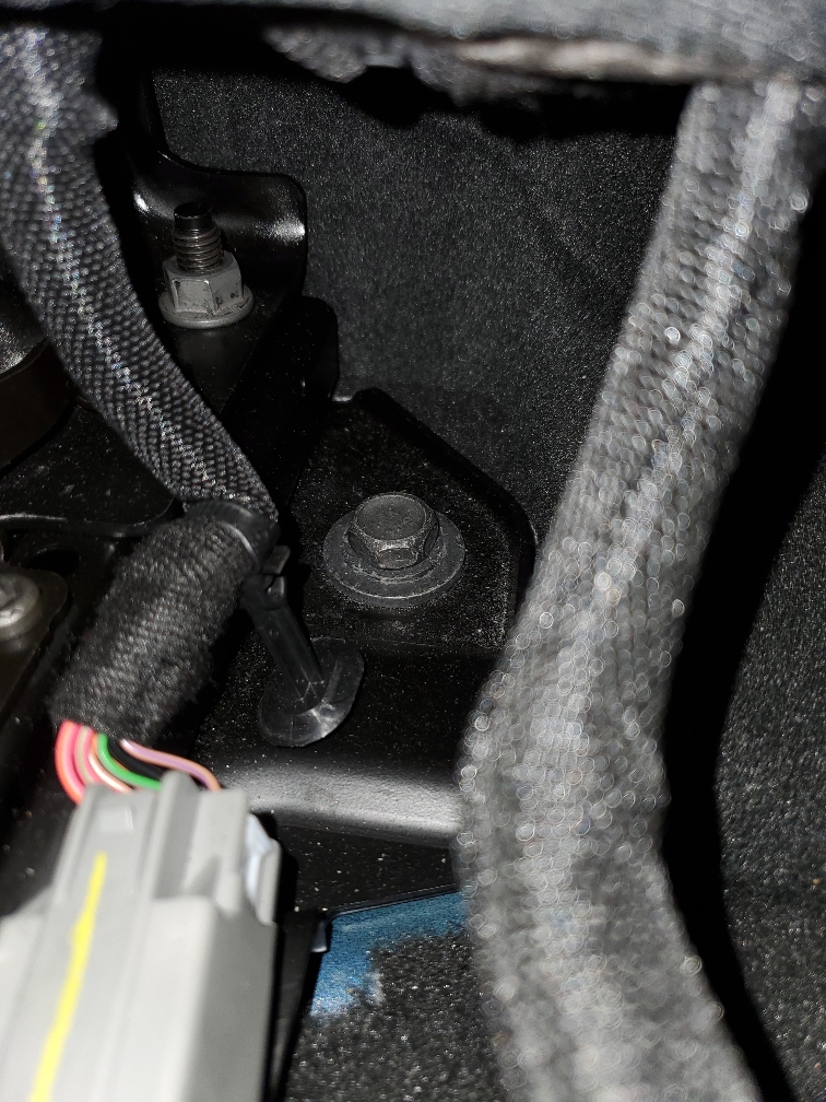

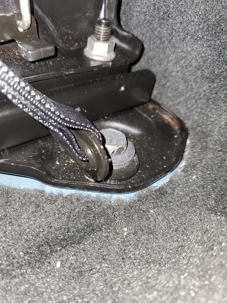

Anyone experience A rattle when hitting bumps on the road? Can’t put my finger on it but it sounds like it’s coming from the passenger rear side of the cab. Thought it might have been seat belts but I ruled that out. Any advice?
Yes.. I have it going on in my 2019 Ram 2500 Regular Cab 6.4. its driving me insane. I checked behind the panel where the driver side seatbelt is... FCA used cheap plastic fasteners to hold wiring and everything else in... I corrected that but the rattle still persist. I tightened B pillar cab mounts... Noise stopped for 1 hour and then returned.
The rattles sound in mine is from these bolt, there is a washer in each bolt so they making really loud noise whenever I'm go over a bump.
Where are these located in the truck?

I found the exact rattle as you explained. I just noticed my driver side rear seat latch is loose.
Yes i had the same thing the push pins are loose too i just used some velcro it stick it to the wall..
thank you for your thread and photos. I had the same rattle on my 22 ram. Velcro solved the problem. Thank you
