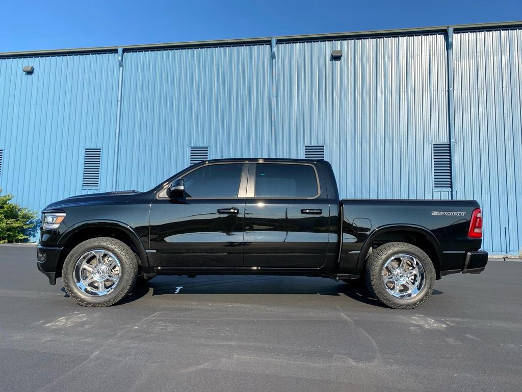

Put the front to the stock setting clip if that’s the case. This was stock with 33s. Non orp

ferrai0l01 - I'm surprised that's at stock height as it appears to have a decent stance. My truck visually has much more rake.
ferraiolo1
Aug 18, 2021
2,307
3,599
North Central PA
Well the front is stock. Rear is lowered 2in there.
Imo I wouldn’t ad any lift to these trucks if only running a 33.
Heck I’m running basically a 33 now on a 2/4in drop
