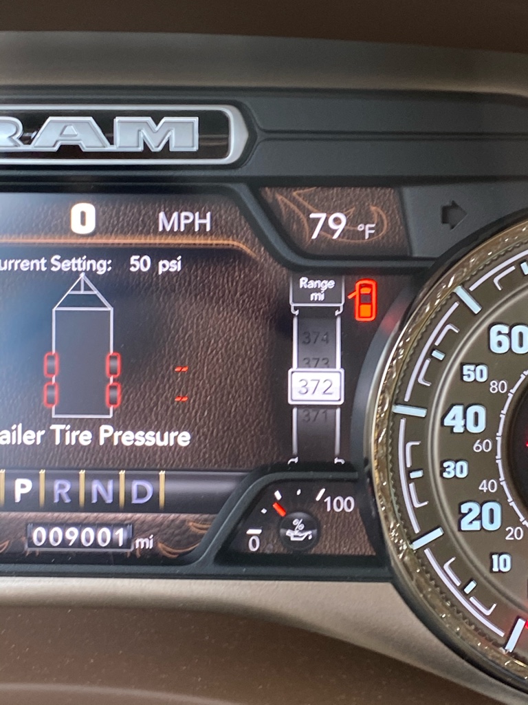

It is not on my 2020 Big Horn sticker either but as you see in the picture there is also another indictor to the right of the center cluster that it is open.

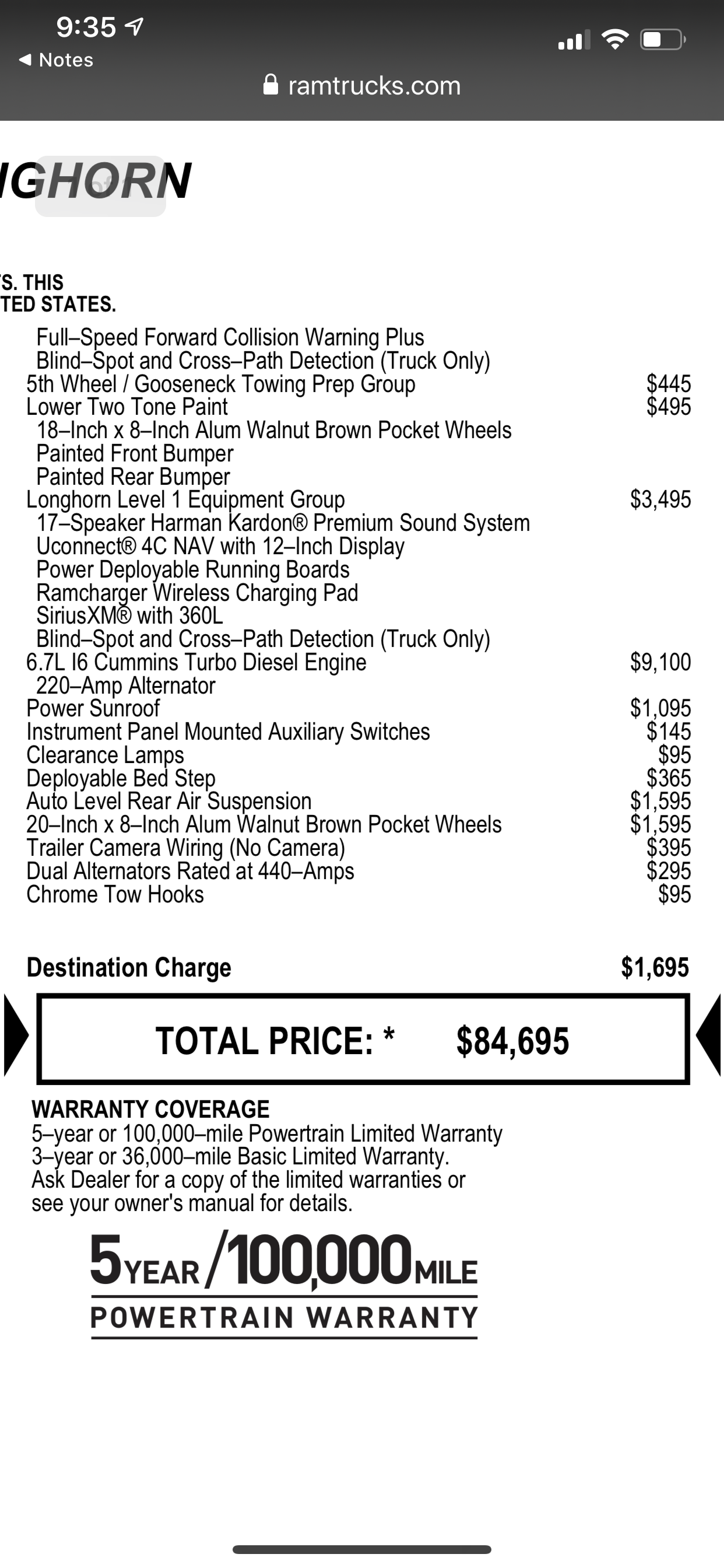

Mine was fully loaded at close to $85k, and I don’t see it either.

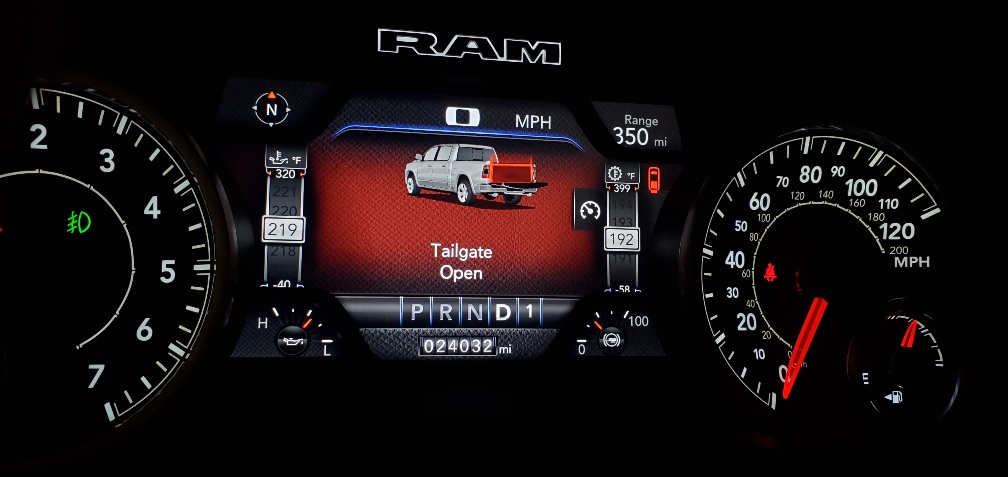

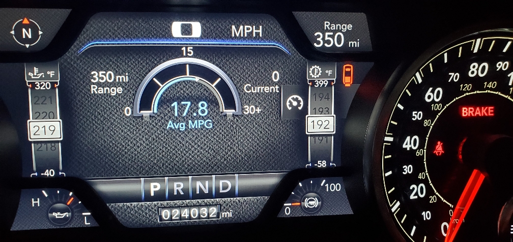

This is what it looks like.
It shows the graphics when you start driving but when you click OK it goes away and then you can only see the small light in the top right corner of the screen
