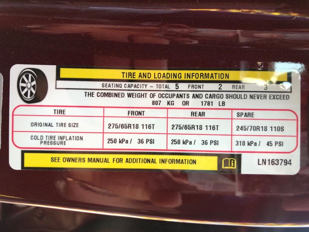

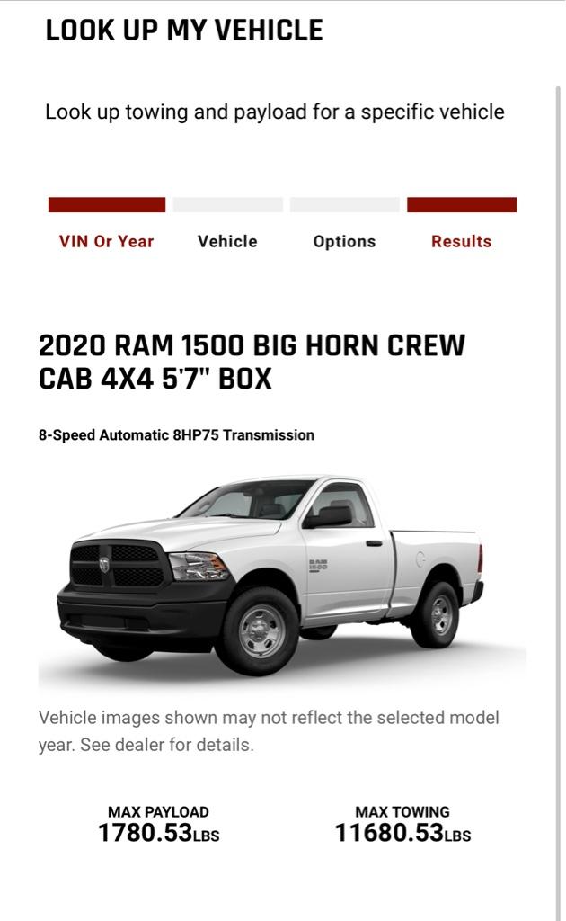

Both door sticker and vin lookup indicate 1780. I have a Big Horn not a Long Horn...same trim AFAIK.
Sorry. You said the TV was a 2020 Longhorn. in what I quoted @blakei
I should have looked at your signature.
Longhorn is a gussied up Laramie.
Lone Star is the same as Big Horn.
Now your numbers make perfect sense.
Thanks for the reply.
