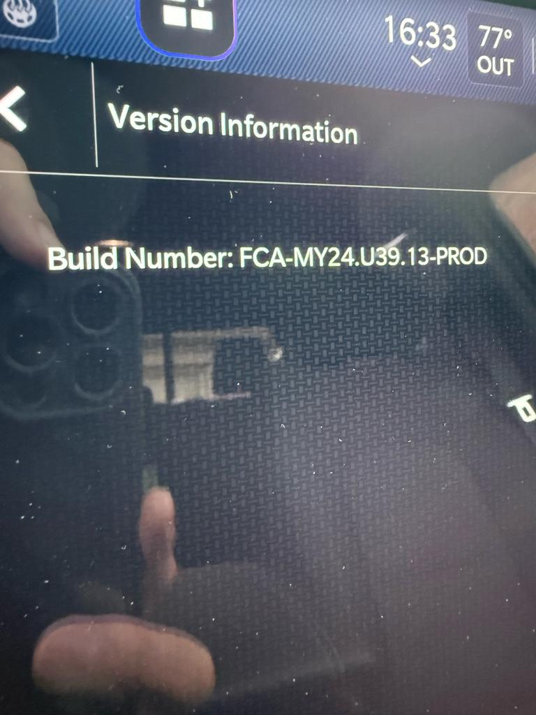

Same. I got the R5T or RT5 message after it finished updating. My software shows this:
39.13 has been out for quite some time (possibly back to July 2025). And after searching some threads elsewhere, this R5T update has been being pushed out since October at least. Still not sure what it is, since it doesn’t seem to be a newer Uconnect version. But it’s has surged lately.
R5T is the telematics box update, not a radio update. The telematics box is the same thing as the Uconnect box (this fixes the “Uconnect box requires service” message some people constantly get). It’s for the connected services, and this has been an update since August or September. They paused all OTA updates for a while, so they must have just started them back up again.
Ah. Where can I see the software version?

I dont know if I have (R5T) version. Pic below of my current software versions. Unless i dont know how to get the info on my non-Nav version.

I guess I was not clear enough.

You won’t find the telematics box version anywhere in your radio. If it updated from R5N to R5T back in November, it wouldn’t have updated to R5T again yesterday.
Jimmy,
Is this the correct screen to find the version?
Thanks
