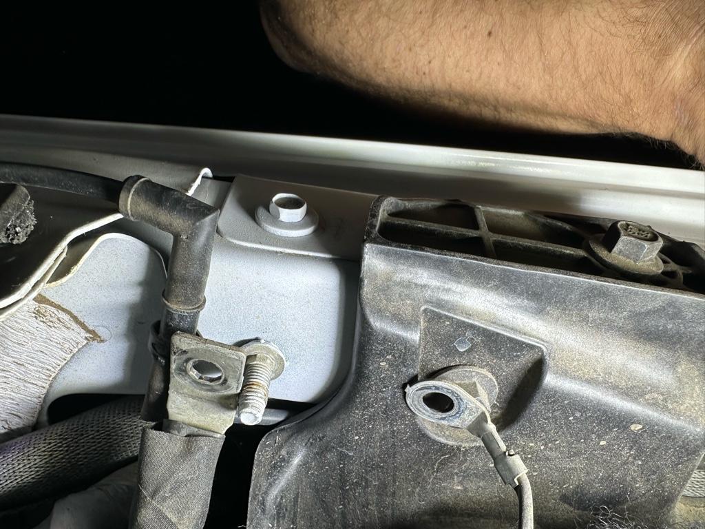

@ZombieSlayer - you mentioned to check grounds on the drivers side. Any suggestions on what I'm looking for?

@ZombieSlayer - you mentioned to check grounds on the drivers side. "Any suggestions on what I'm looking for?"
Make sure everything is shiny and tight.
Thanks - I saw that connection and it was painted up.
I’ll get after that.
I hit that with some steel wool. Seemed clean enough.
I’m going to put in an AGM battery.
I take it that is before cleaning.
Looks like mine with the gray oxide film when I was going thru the battery drain episode.
Yes, those were the before cleaning pics.
