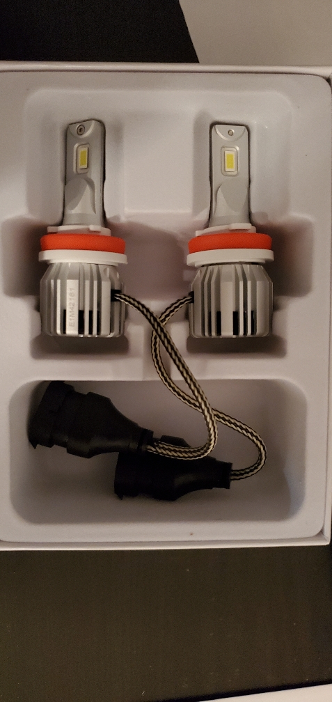

I received my box with my low beams inside them ( but no truck to put them in...lol). It's super simple to just rotate the LED bulb. I attached a picture if it. Right below the rubber orange seal, you can rotate the white piece so you can aim the bulb and not the entire housing. Hope that helps. I ordered another set for the fog lights. Not to bad for spending roughly $70 for all for of them. I look back now and I wish I got diode dynamic ones.
Long term, I can see myself just paying the extra $$ and get factory led headlights.
