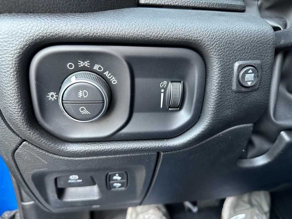

Somewhere I posted pictures of where I did it and how I did it. I used the panel on the left, near the light controls. Hmmm. Not sure where I posted my thread...
Thanks for the clue. I got it installed.
Nicely done. I currently have an on/off switch there that powers my light bar, but I’m thinking about upgrading to an 8 gang switch panel. Wasn’t sure what I wanted to do with the void from the button I have there currently, but I think I might get one of these override switches and do the same.

Couple of suggestions if I might. I don’t believe you are going to get the truck to integrate the steps with the uConnect system. At least not with only a simple configuration change that is.
I 100% recommend the amp override switch like pictured above. It’s cheap, quick and easy to install, and the 3 way toggle switch will give you the exact function you described (minus touchscreen integration). I get the cool factor of having it integrated with you radio, but honestly the toggle switch is very convenient and is almost passable as an OEM switch in my opinion. I use my override switch way more than I thought I would, and it is well worth the price if you want the added functionality.
For the OBD portion you mentioned, I’d recommend grabbing an OBD splitter. I have a cheap splitter from Amazon. My steps are plugged into the splitter and zip tied neatly up under the dash out of sight, leaving access to your main port.

Here is a link to thread with pix of my install.
I -love- the manual three-way switch. I placed it near the foot pedal adjustment rocker. YMMV.

I had Amp boards on my ‘18 2500. I had thought about getting a switch like shown, but then found out that you must have the correct controller too. I did have to replace my controller unit when I was having the boards not retracting correctly.
Replacing that fixed it. Then I called Amp about getting a switch and I was told that I would need the correct controller. The standard one would not work which I had just installed. Unless something has changed with the controllers, just buying the switch is a no go.
Really though, just put your foot on the board, close the door.
