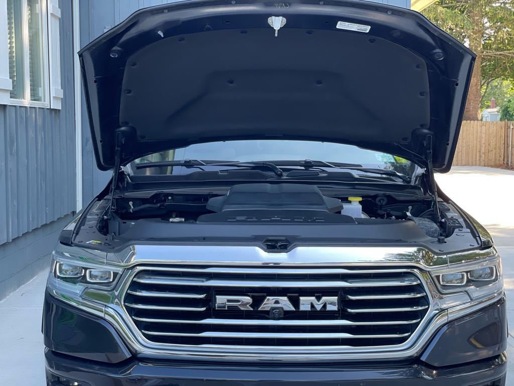

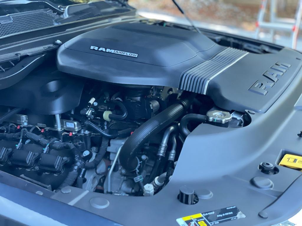

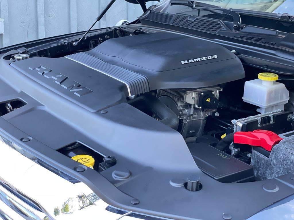

It's not really a real "RamAir" in that it actually "Rams" air into the intake. It's a play on words with Ram truck and air intake.I can't wait to get one. Being that it is a "ram air" intake makes perfectly good sense for the improvement at higher speed. My Hayabusa had the same discussions about ram air... Last time I checked, you still can't measure the ram air affect on a dyne. Someone calculated that the ram air was worth about 10-15 hp at 180 mph on the Suzuki. With that being said, I'm sure its worth a little something on the big end. IMHO, if it did absolutely nothing, I don't think a manufacturer would install it. Hell, if I'm Ram, I wouldn't install it. I can make more in the aftermarket arena selling to the speed freaks like me.
It actually is a ram air intake. It's an OTR style, and some of the air that's forced through the grille gets forced into the intake.It's not really a real "RamAir" in that it actually "Rams" air into the intake. It's a play on words with Ram truck and air intake.
Except with grill shutters that prevent any "ram air" action above 35mphIt actually is a ram air intake. It's an OTR style, and some of the air that's forced through the grille gets forced into the intake.
Interesting point that I didn't think about. I definitely nerd to take a look at the air flow path.Except with grill shutters that prevent any "ram air" action above 35mph
Do you know this for a fact, or is that your assumption? I'm pretty sure it pulls air from in front of the AGS, but I don't have a truck with one of these installed anymore. Maybe someone who has this intake can confirm if this is the case or not. But I think it would be a bit silly to design a ram intake to pull in air from behind grille shutters that restrict incoming air at speed.Except with grill shutters that prevent any "ram air" action above 35mph
Yes, I know for a fact. It's basically a Vararam with a cover on top of it. There is still some air that gets to radiator under the grill shutters, but not enough I'd call it a Ram air effect. And even if you removed the grill shutters, I doubt there is enough air being forced into the intake to really be a true ram air. You will get outside air that hasn't been heated up by the engine, but that's about the only benefit. Unless there is positive pressure inside the airbox when driving, there is no added benefit, or "ram air" being forced into engine.Do you know this for a fact, or is that your assumption? I'm pretty sure it pulls air from in front of the AGS, but I don't have a truck with one of these installed anymore. Maybe someone who has this intake can confirm if this is the case or not. But I think it would be a bit silly to design a ram intake to pull in air from behind grille shutters that restrict incoming air at speed.
Where did you obtain this fact? Personal experience, something you read, or are you making a SWAG? Nothing personal against you, but claiming something is a fact without anything to back it up isn't convincing for me, especially in a forum environment. I'm kicking myself for not paying more attention to where the intake air enters when I had one installed. You've peaked my interest on this now. I'll see if I can find time to remove the rad cover on the wife's Limited. I still have the intake from my truck, so I can temporarily fit it and see for myself.Yes, I know for a fact. It's basically a Vararam with a cover on top of it. There is still some air that gets to radiator under the grill shutters, but not enough I'd call it a Ram air effect. And even if you removed the grill shutters, I doubt there is enough air being forced into the intake to really be a true ram air. You will get outside air that hasn't been heated up by the engine, but that's about the only benefit. Unless there is positive pressure inside the airbox when driving, there is no added benefit, or "ram air" being forced into engine.
Own a Vararam and have seen a couple of the RamAir intakes in person. You're welcome to verify for yourself, but I know what I know.Where did you obtain this fact? Personal experience, something you read, or are you making a SWAG? Nothing personal against you, but claiming something is a fact without anything to back it up isn't convincing for me, especially in a forum environment. I'm kicking myself for not paying more attention to where the intake air enters when I had one installed. You've peaked my interest on this now. I'll see if I can find time to remove the rad cover on the wife's Limited. I still have the intake from my truck, so I can temporarily fit it and see for myself.![]()
Verified for myself. I didn't even have to remove any covers to verify it. Sorry I doubted what you were saying. I don't understand why they would design it that way, but it is what it is I guess.Own a Vararam and have seen a couple of the RamAir intakes in person. You're welcome to verify for yourself, but I know what I know.
Because it was designed for looks and marketing. Not performanceVerified for myself. I didn't even have to remove any covers to verify it. Sorry I doubted what you were saying. I don't understand why they would design it that way, but it is what it is I guess.
